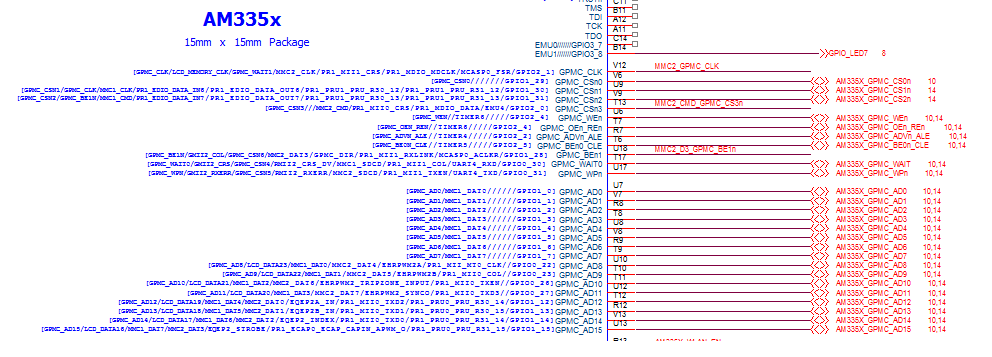

  • Hi, Kemal
    I tried your patch and it works. But still I get 0MB NAND. I have attached the NAND part schematic? I think this part is correct. But any way I have attached here. Any idea about this?

  • Hi, Kernal
    The picture is the updated am335x-evm NAND part schematic from TI. The NAND chip is set to DNI.  But in the previous version of am335x-evm schematic this part  is not set to DNI. So maybe the updated SDK will not support NAND?
    BR
    Yang
  • The nand's size gets printed by this printf("%lu MiB\n", total_nand_size / 1024); in <Processor SDK>/board-support/u-boot-<version>/drivers/mtd/nand/nand.c Please, compare the two U-Boot source trace this code and find why it prints 0 MiB in new U-Boot. Probably the pinmux settings have changed or something.
  • Hi, Kemal
    I have found the root cause. On the function enable_board_pin_mux in the file /board/ti/am335x/mux.c, it showes that on GPEVM profile 2 and 3 don't have NAND. So it just do not set the NAND pin mux.
    BR
