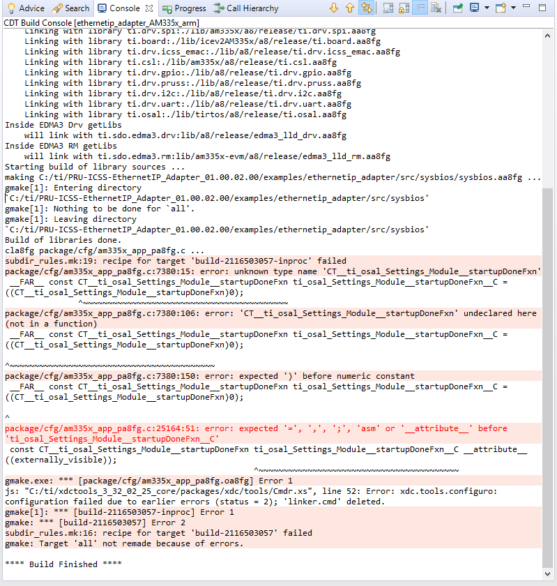

I generated ethernetip_adapter project for icev2AM335x. The wiki of PRU_ICSS_EthernetIP indicates the system requirement is PROCESSOR-SDK-RTOS 03_03_00 but I have PROCESSOR-SDK-RTOS 04_03_00_05.
Made necessary changes to projectCreate.bat file.
After generating project and compiling it following are the error
My environment for creating project is as follows

  • Hi Paula,
    I added "-lgcc -lc -lm -lnosys -L$(SYSBIOS)/packages/gnu/targets/arm/libs/install-native/arm-none-eabi/lib/hard --specs=nano.specs" linker flag list. But unfortunately it didn't solve the issue.
    Can you mention which AM335x_PDK_VERSION, XDC_TOOLS_VERSION=3.32.02.25_core, SYS_BIOS_VERSION=6.46.05.55, NDK_VERSION=2.25.01.11 and EDMA_VERSION=2.12.04.28 versions to choose?

  • Hi Paula,
    I installed PSDK3.3, edited flags in projectCreate.bat and generated ethernetip_adapter project. Still I have errors, but a different though.
    Following were the packages installed in PSDK3.3
    So I changes flags in projectCreate.bat file as bellow

  • Hi Paula,
    i don't know why this application is not working for me out of box. As you instructed I deleted project from the drive and the started from scratch. I will attach the build errors. Few redefined errors and some errors are prototype mismatch errors. I believe these errors might have already fixed in some release. Check and update here. Thank you!
    In file included from C:/ti/PRU-ICSS-EthernetIP_Adapter_01.00.02.00/examples/ethernetip_adapter/eip_main.c:48:0:
    C:/ti/PRU-ICSS-EthernetIP_Adapter_01.00.02.00/examples/board/include/board_spi.h:222:20: note: expected 'Board_flashHandle {aka long unsigned int}' but argument is of type 'S25FL_Handle {aka struct S25FL_Object *}'
     Board_flash_STATUS Board_flashOffsetToBlkPage(Board_flashHandle  handle,
    C:/ti/PRU-ICSS-EthernetIP_Adapter_01.00.02.00/examples/ethernetip_adapter/eip_main.c:455:29: warning: passing argument 1 of 'Board_flashEraseBlk' makes integer from pointer without a cast [-Wint-conversion]
             Board_flashEraseBlk(flashHandle, blockNum);
    C:/ti/PRU-ICSS-EthernetIP_Adapter_01.00.02.00/examples/board/include/board_spi.h:202:20: note: expected 'Board_flashHandle {aka long unsigned int}' but argument is of type 'S25FL_Handle {aka struct S25FL_Object *}'
     Board_flash_STATUS Board_flashEraseBlk(Board_flashHandle handle,
    C:/ti/PRU-ICSS-EthernetIP_Adapter_01.00.02.00/examples/ethernetip_adapter/eip_main.c:456:26: warning: passing argument 1 of 'Board_flashWrite' makes integer from pointer without a cast [-Wint-conversion]

    C:/ti/PRU-ICSS-EthernetIP_Adapter_01.00.02.00/examples/ethernetip_adapter/eip_utils.c:384:29: warning: passing argument 1 of 'Board_flashEraseBlk' makes integer from pointer without a cast [-Wint-conversion]
    In file included from C:/ti/PRU-ICSS-EthernetIP_Adapter_01.00.02.00/examples/ethernetip_adapter/eip_utils.c:41:0:
    C:/ti/PRU-ICSS-EthernetIP_Adapter_01.00.02.00/examples/ethernetip_adapter/eip_utils.c:385:26: warning: passing argument 1 of 'Board_flashWrite' makes integer from pointer without a cast [-Wint-conversion]
             Board_flashWrite(flashHandle, SPI_EEPROM_DEVICEIP_OFFSET,
    C:/ti/PRU-ICSS-EthernetIP_Adapter_01.00.02.00/examples/board/include/board_spi.h:185:20: note: expected 'Board_flashHandle {aka long unsigned int}' but argument is of type 'S25FL_Handle {aka struct S25FL_Object *}'
     Board_flash_STATUS Board_flashWrite(Board_flashHandle  handle,
    gmake: *** [eip_utils.o] Error 1
    In file included from C:/ti/ndk_2_25_01_11/packages/ti/ndk/inc/socket.h:43:0,
                     from C:/ti/ndk_2_25_01_11/packages/ti/ndk/inc/stacksys.h:77,
                     from C:/ti/ndk_2_25_01_11/packages/ti/ndk/inc/netmain.h:39,
                     from C:/ti/PRU-ICSS-EthernetIP_Adapter_01.00.02.00/third_party/protocols/ethernetip_adapter/include/os_inc.h:48,
                     from C:/ti/PRU-ICSS-EthernetIP_Adapter_01.00.02.00/third_party/protocols/ethernetip_adapter/include/adt_config.h:245,
                     from C:/ti/PRU-ICSS-EthernetIP_Adapter_01.00.02.00/third_party/protocols/ethernetip_adapter/include/app_api.h:27,
                     from C:/ti/PRU-ICSS-EthernetIP_Adapter_01.00.02.00/examples/ethernetip_adapter/eip_main.h:40,
                     from C:/ti/PRU-ICSS-EthernetIP_Adapter_01.00.02.00/protocols/ethernetip_adapter/drivers/icss_dlr.c:41:
    C:/ti/ndk_2_25_01_11/packages/ti/ndk/inc/socketndk.h:293:8: error: redefinition of 'struct timeval'
     struct timeval {
    In file included from c:\ti\ccsv7\tools\compiler\gcc-arm-none-eabi-6-2017-q1-update\arm-none-eabi\include\sys\select.h:26:0,
                     from c:\ti\ccsv7\tools\compiler\gcc-arm-none-eabi-6-2017-q1-update\arm-none-eabi\include\sys\types.h:68,
                     from c:\ti\ccsv7\tools\compiler\gcc-arm-none-eabi-6-2017-q1-update\arm-none-eabi\include\stdio.h:61,
                     from C:/ti/PRU-ICSS-EthernetIP_Adapter_01.00.02.00/third_party/protocols/ethernetip_adapter/include/os_inc.h:26,
    c:\ti\ccsv7\tools\compiler\gcc-arm-none-eabi-6-2017-q1-update\arm-none-eabi\include\sys\_timeval.h:52:8: note: originally defined here
     struct timeval {
    In file included from C:/ti/ndk_2_25_01_11/packages/ti/ndk/inc/nettools/nettools.h:86:0,
                     from C:/ti/ndk_2_25_01_11/packages/ti/ndk/inc/_nettool.h:39,
                     from C:/ti/ndk_2_25_01_11/packages/ti/ndk/inc/netmain.h:40,
    C:/ti/ndk_2_25_01_11/packages/ti/ndk/inc/nettools/inc/dnsif.h:54:0: warning: "OVERFLOW" redefined
     #define OVERFLOW        16              /* buffer overflow */
    In file included from C:/ti/PRU-ICSS-EthernetIP_Adapter_01.00.02.00/protocols/timeSync/include/icss_timeSync.h:17:0,
                     from C:/ti/PRU-ICSS-EthernetIP_Adapter_01.00.02.00/protocols/ethernetip_adapter/include/icss_eip_driver.h:149,
                     from C:/ti/PRU-ICSS-EthernetIP_Adapter_01.00.02.00/protocols/ethernetip_adapter/drivers/icss_dlr.c:23:
    c:\ti\ccsv7\tools\compiler\gcc-arm-none-eabi-6-2017-q1-update\arm-none-eabi\include\math.h:622:0: note: this is the location of the previous definition
     #define OVERFLOW 3
    C:/ti/PRU-ICSS-EthernetIP_Adapter_01.00.02.00/protocols/ethernetip_adapter/drivers/icss_dlr.c: In function 'EIP_DLR_init':
    C:/ti/PRU-ICSS-EthernetIP_Adapter_01.00.02.00/protocols/ethernetip_adapter/drivers/icss_dlr.c:174:5: warning: implicit declaration of function 'addMACID' [-Wimplicit-function-declaration]
         addMACID(dlrHandle->dlrEmptyFrame + DLR_SRC_MAC_OFFSET, ifMacID);
    C:/ti/PRU-ICSS-EthernetIP_Adapter_01.00.02.00/protocols/ethernetip_adapter/drivers/icss_dlr.c:181:5: warning: implicit declaration of function 'addWord' [-Wimplicit-function-declaration]
         addWord(dlrHandle->dlrEmptyFrame + DLR_SOURCE_IP_OFFSET, dlrHandle->deviceIP);
    C:/ti/PRU-ICSS-EthernetIP_Adapter_01.00.02.00/protocols/ethernetip_adapter/drivers/icss_dlr.c: In function 'EIP_DLR_port0ISR':
    C:/ti/PRU-ICSS-EthernetIP_Adapter_01.00.02.00/protocols/ethernetip_adapter/drivers/icss_dlr.c:402:9: warning: implicit declaration of function 'getMACId' [-Wimplicit-function-declaration]
             getMACId((uint8_t *)wordPtr, actSupAddrPtr->supMACAddress);
    C:/ti/PRU-ICSS-EthernetIP_Adapter_01.00.02.00/protocols/ethernetip_adapter/drivers/icss_dlr.c:408:39: warning: implicit declaration of function 'convBigEndianToLittleEndianWord' [-Wimplicit-function-declaration]
             actSupAddrPtr->supIPAddress = convBigEndianToLittleEndianWord((
    C:/ti/PRU-ICSS-EthernetIP_Adapter_01.00.02.00/protocols/ethernetip_adapter/drivers/icss_dlr.c: In function 'EIP_DLR_processDLRFrame':
    C:/ti/PRU-ICSS-EthernetIP_Adapter_01.00.02.00/protocols/ethernetip_adapter/drivers/icss_dlr.c:1458:20: warning: implicit declaration of function 'convBigEndianToLittleEndianHalfWord' [-Wimplicit-function-declaration]
             numNodes = convBigEndianToLittleEndianHalfWord(dlrSrc +
    gmake: *** [icss_dlr.o] Error 1
    'Building file: "C:/ti/PRU-ICSS-EthernetIP_Adapter_01.00.02.00/examples/ethernetip_adapter/main.c"'
    'Invoking: GNU Compiler'
    "C:/ti/ccsv7/tools/compiler/gcc-arm-none-eabi-6-2017-q1-update/bin/arm-none-eabi-gcc.exe" -c -mcpu=cortex-a8 -mtune=cortex-a8 -march=armv7-a -marm -mfloat-abi=hard -mfpu=neon -DSOC_AM335x -Dicev2AM335x -Dcore0 -DPTP_TESTING -Dam3359 -I"C:/ti/PRU-ICSS-EthernetIP_Adapter_01.00.02.00/protocols/ethernetip_adapter/projects/ethernetip_adapter_AM335x_arm" -I"C:/ti/pdk_am335x_1_0_6/packages" -I"C:/ti/pdk_am335x_1_0_6/packages/ti/starterware/include/am335x" -I"C:/ti/PRU-ICSS-EthernetIP_Adapter_01.00.02.00" -I"C:/ti/ndk_2_25_01_11" -I"C:/ti/PRU-ICSS-EthernetIP_Adapter_01.00.02.00/examples/ethernetip_adapter" -I"C:/ti/PRU-ICSS-EthernetIP_Adapter_01.00.02.00/protocols/ethernetip_adapter/include" -I"C:/ti/PRU-ICSS-EthernetIP_Adapter_01.00.02.00/third_party/protocols/ethernetip_adapter/include" -I"C:/ti/PRU-ICSS-EthernetIP_Adapter_01.00.02.00/protocols/timeSync/include" -I"C:/ti/PRU-ICSS-EthernetIP_Adapter_01.00.02.00/third_party/protocols/ptp/ptpd/dep" -I"C:/ti/ccsv7/tools/compiler/gcc-arm-none-eabi-6-2017-q1-update/arm-none-eabi/include" -O2 -ffunction-sections -fdata-sections -g -gdwarf-2 -gstrict-dwarf -Wall -mno-unaligned-access -MMD -MP -MF"main.d" -MT"main.o" @"configPkg/compiler.opt" -o"main.o" "C:/ti/PRU-ICSS-EthernetIP_Adapter_01.00.02.00/examples/ethernetip_adapter/main.c"
    subdir_rules.mk:100: recipe for target 'main.o' failed
                     from C:/ti/ndk_2_25_01_11/packages/ti/ndk/inc/stkmain.h:39,
                     from C:/ti/PRU-ICSS-EthernetIP_Adapter_01.00.02.00/examples/ethernetip_adapter/main.c:50:
     struct timeval {
                     from C:/ti/PRU-ICSS-EthernetIP_Adapter_01.00.02.00/examples/ethernetip_adapter/main.c:39:
     struct timeval {
    C:/ti/PRU-ICSS-EthernetIP_Adapter_01.00.02.00/examples/ethernetip_adapter/main.c: In function 'pruss_iep_MDIOInitialization':
    C:/ti/PRU-ICSS-EthernetIP_Adapter_01.00.02.00/examples/ethernetip_adapter/main.c:415:5: warning: implicit declaration of function 'ICSS_EMAC_testDelay' [-Wimplicit-function-declaration]
         ICSS_EMAC_testDelay(50);
    C:/ti/PRU-ICSS-EthernetIP_Adapter_01.00.02.00/examples/ethernetip_adapter/main.c: At top level:
    C:/ti/PRU-ICSS-EthernetIP_Adapter_01.00.02.00/examples/ethernetip_adapter/main.c:418:6: warning: conflicting types for 'ICSS_EMAC_testDelay'
     void ICSS_EMAC_testDelay(uint32_t delay)
    C:/ti/PRU-ICSS-EthernetIP_Adapter_01.00.02.00/examples/ethernetip_adapter/main.c:415:5: note: previous implicit declaration of 'ICSS_EMAC_testDelay' was here
    C:/ti/PRU-ICSS-EthernetIP_Adapter_01.00.02.00/examples/ethernetip_adapter/main.c: In function 'main':
    C:/ti/PRU-ICSS-EthernetIP_Adapter_01.00.02.00/examples/ethernetip_adapter/main.c:452:5: warning: implicit declaration of function 'PRCMModuleEnable' [-Wimplicit-function-declaration]
         PRCMModuleEnable(CHIPDB_MOD_ID_PWMSS, 0, 0);
    gmake: *** [main.o] Error 1
    'Building file: "C:/ti/PRU-ICSS-EthernetIP_Adapter_01.00.02.00/examples/ethernetip_adapter/hal.c"'
    "C:/ti/ccsv7/tools/compiler/gcc-arm-none-eabi-6-2017-q1-update/bin/arm-none-eabi-gcc.exe" -c -mcpu=cortex-a8 -mtune=cortex-a8 -march=armv7-a -marm -mfloat-abi=hard -mfpu=neon -DSOC_AM335x -Dicev2AM335x -Dcore0 -DPTP_TESTING -Dam3359 -I"C:/ti/PRU-ICSS-EthernetIP_Adapter_01.00.02.00/protocols/ethernetip_adapter/projects/ethernetip_adapter_AM335x_arm" -I"C:/ti/pdk_am335x_1_0_6/packages" -I"C:/ti/pdk_am335x_1_0_6/packages/ti/starterware/include/am335x" -I"C:/ti/PRU-ICSS-EthernetIP_Adapter_01.00.02.00" -I"C:/ti/ndk_2_25_01_11" -I"C:/ti/PRU-ICSS-EthernetIP_Adapter_01.00.02.00/examples/ethernetip_adapter" -I"C:/ti/PRU-ICSS-EthernetIP_Adapter_01.00.02.00/protocols/ethernetip_adapter/include" -I"C:/ti/PRU-ICSS-EthernetIP_Adapter_01.00.02.00/third_party/protocols/ethernetip_adapter/include" -I"C:/ti/PRU-ICSS-EthernetIP_Adapter_01.00.02.00/protocols/timeSync/include" -I"C:/ti/PRU-ICSS-EthernetIP_Adapter_01.00.02.00/third_party/protocols/ptp/ptpd/dep" -I"C:/ti/ccsv7/tools/compiler/gcc-arm-none-eabi-6-2017-q1-update/arm-none-eabi/include" -O2 -ffunction-sections -fdata-sections -g -gdwarf-2 -gstrict-dwarf -Wall -mno-unaligned-access -MMD -MP -MF"hal.d" -MT"hal.o" @"configPkg/compiler.opt" -o"hal.o" "C:/ti/PRU-ICSS-EthernetIP_Adapter_01.00.02.00/examples/ethernetip_adapter/hal.c"
    subdir_rules.mk:79: recipe for target 'hal.o' failed
                     from C:/ti/PRU-ICSS-EthernetIP_Adapter_01.00.02.00/examples/ethernetip_adapter/hal.c:40:
    c:\ti\ccsv7\tools\compiler\gcc-arm-none-eabi-6-2017-q1-update\arm-none-eabi\include\sys\_timeval.h:52:8: error: redefinition of 'struct timeval'
     struct timeval {
                     from C:/ti/PRU-ICSS-EthernetIP_Adapter_01.00.02.00/examples/ethernetip_adapter/hal.c:39:
    C:/ti/ndk_2_25_01_11/packages/ti/ndk/inc/socketndk.h:293:8: note: originally defined here
     struct timeval {
    C:/ti/PRU-ICSS-EthernetIP_Adapter_01.00.02.00/examples/ethernetip_adapter/hal.c: In function 'EIPHAL_setConfigurationControl':
    C:/ti/PRU-ICSS-EthernetIP_Adapter_01.00.02.00/examples/ethernetip_adapter/hal.c:228:40: warning: passing argument 1 of 'Board_flashOffsetToBlkPage' makes integer from pointer without a cast [-Wint-conversion]
                 Board_flashOffsetToBlkPage(flashHandle, SPI_EEPROM_DEVICEIP_OFFSET,
    In file included from C:/ti/PRU-ICSS-EthernetIP_Adapter_01.00.02.00/examples/ethernetip_adapter/hal.c:49:0:
    C:/ti/PRU-ICSS-EthernetIP_Adapter_01.00.02.00/examples/ethernetip_adapter/hal.c:231:33: warning: passing argument 1 of 'Board_flashEraseBlk' makes integer from pointer without a cast [-Wint-conversion]
    C:/ti/PRU-ICSS-EthernetIP_Adapter_01.00.02.00/examples/ethernetip_adapter/hal.c:232:30: warning: passing argument 1 of 'Board_flashWrite' makes integer from pointer without a cast [-Wint-conversion]
    C:/ti/PRU-ICSS-EthernetIP_Adapter_01.00.02.00/examples/ethernetip_adapter/hal.c:239:40: warning: passing argument 1 of 'Board_flashOffsetToBlkPage' makes integer from pointer without a cast [-Wint-conversion]
    C:/ti/PRU-ICSS-EthernetIP_Adapter_01.00.02.00/examples/ethernetip_adapter/hal.c:242:33: warning: passing argument 1 of 'Board_flashEraseBlk' makes integer from pointer without a cast [-Wint-conversion]
    C:/ti/PRU-ICSS-EthernetIP_Adapter_01.00.02.00/examples/ethernetip_adapter/hal.c:243:30: warning: passing argument 1 of 'Board_flashWrite' makes integer from pointer without a cast [-Wint-conversion]
    C:/ti/PRU-ICSS-EthernetIP_Adapter_01.00.02.00/examples/ethernetip_adapter/hal.c: In function 'EIPHAL_setInterfaceConfiguration':
    C:/ti/PRU-ICSS-EthernetIP_Adapter_01.00.02.00/examples/ethernetip_adapter/hal.c:289:32: warning: passing argument 1 of 'Board_flashOffsetToBlkPage' makes integer from pointer without a cast [-Wint-conversion]
    C:/ti/PRU-ICSS-EthernetIP_Adapter_01.00.02.00/examples/ethernetip_adapter/hal.c:292:25: warning: passing argument 1 of 'Board_flashEraseBlk' makes integer from pointer without a cast [-Wint-conversion]
    C:/ti/PRU-ICSS-EthernetIP_Adapter_01.00.02.00/examples/ethernetip_adapter/hal.c:293:22: warning: passing argument 1 of 'Board_flashWrite' makes integer from pointer without a cast [-Wint-conversion]
    C:/ti/PRU-ICSS-EthernetIP_Adapter_01.00.02.00/examples/ethernetip_adapter/hal.c: In function 'EIPHAL_getInterfaceSpeed':
    C:/ti/PRU-ICSS-EthernetIP_Adapter_01.00.02.00/examples/ethernetip_adapter/hal.c:376:18: warning: implicit declaration of function 'MDIO_getPhyConfig' [-Wimplicit-function-declaration]
             phyVal = MDIO_getPhyConfig((((ICSS_EmacHwAttrs *)
    C:/ti/PRU-ICSS-EthernetIP_Adapter_01.00.02.00/examples/ethernetip_adapter/hal.c: In function 'EIPHAL_getInterfaceFlags':
    C:/ti/PRU-ICSS-EthernetIP_Adapter_01.00.02.00/examples/ethernetip_adapter/hal.c:436:12: warning: implicit declaration of function 'MDIO_getAutoNegCompleteStat' [-Wimplicit-function-declaration]
             if(MDIO_getAutoNegCompleteStat((((ICSS_EmacHwAttrs *)
    C:/ti/PRU-ICSS-EthernetIP_Adapter_01.00.02.00/examples/ethernetip_adapter/hal.c:441:16: warning: implicit declaration of function 'MDIO_getLinkPartnerAutonegAble' [-Wimplicit-function-declaration]
                 if(MDIO_getLinkPartnerAutonegAble((((ICSS_EmacHwAttrs *)
    C:/ti/PRU-ICSS-EthernetIP_Adapter_01.00.02.00/examples/ethernetip_adapter/hal.c: In function 'EIPHAL_setInterfaceControl':
    C:/ti/PRU-ICSS-EthernetIP_Adapter_01.00.02.00/examples/ethernetip_adapter/hal.c:648:32: warning: passing argument 1 of 'Board_flashOffsetToBlkPage' makes integer from pointer without a cast [-Wint-conversion]
         Board_flashOffsetToBlkPage(flashHandle, SPI_EEPROM_SPEED_OFFSET,
    C:/ti/PRU-ICSS-EthernetIP_Adapter_01.00.02.00/examples/ethernetip_adapter/hal.c:651:25: warning: passing argument 1 of 'Board_flashEraseBlk' makes integer from pointer without a cast [-Wint-conversion]

  • Hi Vinay, no sure what is not working for you.. I just gave a try and it worked OOB. Attached my logs.
    High level steps:
    - Run setup environment scripts (from PSDK or from PDK)
    - Move to <EIP_install_path>\protocols\Ethernetip_adapter\ and run ProjectCreate.bat
    - Import project in CCS, clean and build.
    Attached my logs for your reference
    EIP_adapter_1.0.2_CCSbuildingLogs.txt

    C:\TI\PRU-ICSS-EthernetIP_Adapter_01.00.02.00\protocols\ethernetip_adapter\projects>
    thank you,
    Paula
