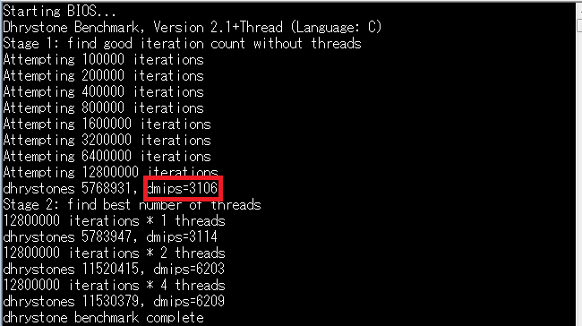

    I tried to test with your additional infomation : processors.wiki.ti.com/.../Processor_SDK_Posix-SMP_Demo
    The following DMIPS values were obtained from the test results of the A15 core:
    Since I was using OPP_NOM, the maximum value of A15's DMIPS is 3500(= 1Gh * 3.5 DMIPS/MHz), so I think the CPU utilization of this test program for A15 core is 88.74% (= 3106/3500 * 100).
    In the same way, the following DMIPS values were obtained from the test results of the C66x core.
    Since I was using OPP_NOM, the maximum value of C66x's DMIPS is 4800(= 600MHz * 8 ), so I think the CPU utilization of this test program for C66x core is 5.02% (= 241/4800 * 100).
    Is the above method of calculating my CPU resource correct?

    In general for most of our power estimation tools/spreadsheet for ARM the worst case test we use is Dhrystone , this is consistent with most other vendors.
    For DSP we typically use an "internal only" design hand coded test that essentially has 8 instructions per cycle (IPC of 8) running every cycle in an infinite loop.
    This is a pseudo max test and represents 100% max utilization.
    We are confirming if this is also the same test used for AM57x PET.
    If it is confirmed, I want to make sure it is understood
    1) We do not share this internal test
    2) In general no core kernels or real world applications come close to achieving an IPC of 8, so for all practical purposes you should be ok to put 50% utilization. This will account for typical parallelism and also any cache/memory access stalls etc. If you wanted to be more conservative you can try to keep 75% utilization.
    This should be used as guiding principle to put something in the PET.
