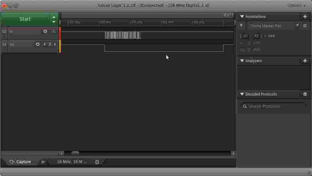

  • Marek,
    I helped Schuyler recreate this using a BBB. I used UART1 as the pins are available on the P9 header (P9-19 and P9-24 to be exact).
    Here are the DTS changes I made:
    diff --git a/arch/arm/boot/dts/am335x-boneblack.dts b/arch/arm/boot/dts/am335x-boneblack.dts
    index 1230fd0..27df4e7 100644
    --- a/arch/arm/boot/dts/am335x-boneblack.dts
    +++ b/arch/arm/boot/dts/am335x-boneblack.dts
    @@ -86,6 +86,24 @@
     			AM33XX_IOPAD(0x86c, PIN_OUTPUT_PULLDOWN | MUX_MODE7) /* gpmc_a11.GPIO1_27 */
    +	uart1_pins_default: uart1_pins_default {
    +		pinctrl-single,pins = <
    +			0x180 ( PIN_INPUT | MUX_MODE0 ) /* (D16) uart1_rxd.uart1_rxd */
    +			0x184 ( PIN_OUTPUT | MUX_MODE0 ) /* (D15) uart1_txd.uart1_txd */
    +			0x178 ( PIN_INPUT | MUX_MODE0 ) /* (D18) uart1_ctsn.uart1_ctsn */
    +			0x17c ( PIN_OUTPUT | MUX_MODE0 ) /* (D17) uart1_rtsn.uart1_rtsn */
    +&uart1 {                // RS485
    +    pinctrl-names = "default";
    +    pinctrl-0 = <&uart1_pins_default>;
    +    status = "okay";
    +    rs485-rts-delay = <200 200>;
    +    linux,rs485-enabled-at-boot-time;
    +    rs485-rts-active-high;
     &lcdc {
    Here's what we captured:
    As you can see, we see RTS strobing as we would expect.
    It seems that something must be different in your set up. If you have a Beaglebone Black, you should be able to recreate the test above easily enough.
    We hope this is helpful.
