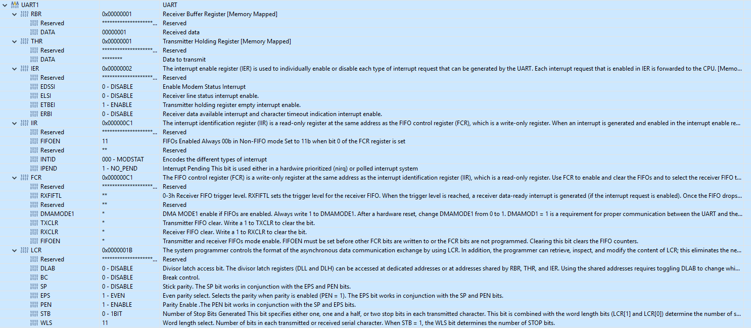

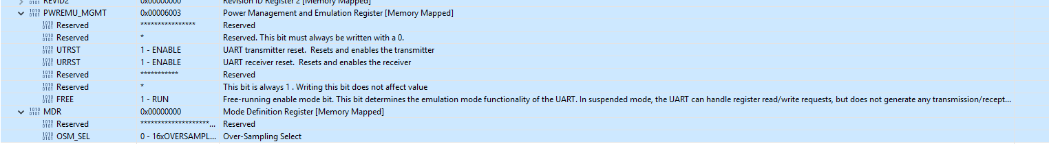

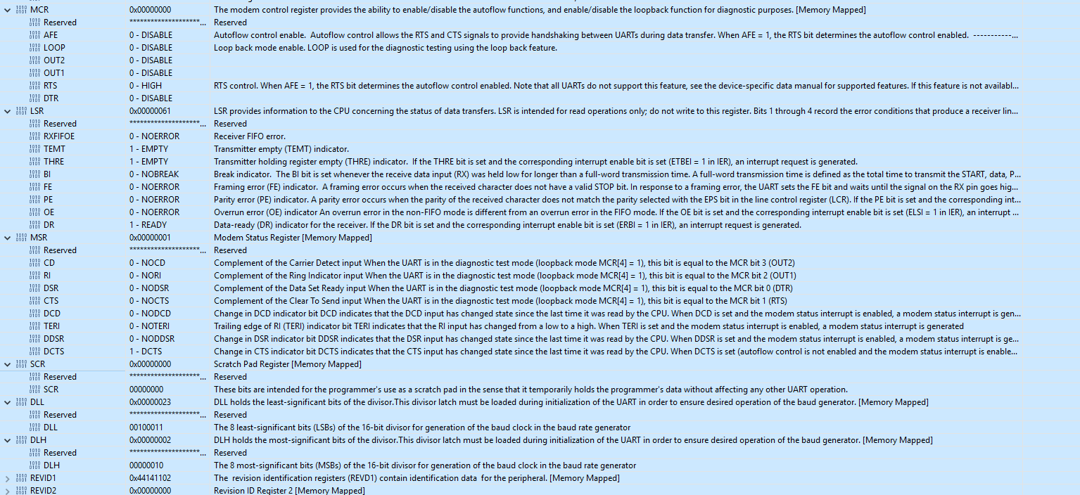

I'm implementing a communication protocol on the C6746 (Modbus), and can receive communication packets via UART1 initially, but when I go to send the reply back, my TX interrupt from the UART is not being generated, to send the characters out.  I'm wondering if anyone can see any issue, just based on my register settings and status, as shown below.  This is right at the point I need to send the characters out.  I've reviewed them at length, with no findings, but probably am overlooking something

  • I believe this UART controller needs to be primed with the first character. I found you need to manually put the first character into THR. After that you should get TX interrupts.
  • That seemed to help/do it, thanks.
    Couple of other things to keep in mind, and that I've learned, for any future reference on this thread:
    - the FCR configuration is a bit tricky.  What I've found, as mentioned in the technical reference (SPRUH80C), is that the FIFOEN bit must be set to 1, by itself (no other bits OR'd in), before any other registers in the FCR can be written.
    - the FCR cannot be read at all
    - the DMAMODE1 bit must be set to 1, regardless whether DMA is being used or not
    For instance, during my FCR configuration, I write twice
    FCR = 9
    FCR = 0x0F
    the first sets the FIFOEN bit, to allow additional writes.  The second hits the FIFOEN bit again, while also setting DMAMODE1 and doing an RXCLR and TXCLR; plus selects 1 byte trigger level for the FIFO ( by writing the 0 to bits 6 and 7 ).
    This is a very important point, and a frequent mistake that I see people make, so I wanted to call it out...  The FCR and IIR registers exist at the same address.  Reads from that address are reading IIR.  Writes to that address are writing FCR.  I see people try things like:
    // don't do this
    FCR |= 1;
    That ends up reading IIR, ORing a value of 1, and then writing to FCR.  Needless to say, you can cause a lot of problems that way!
