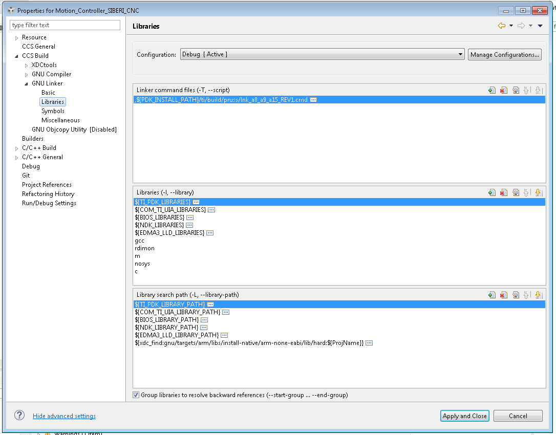

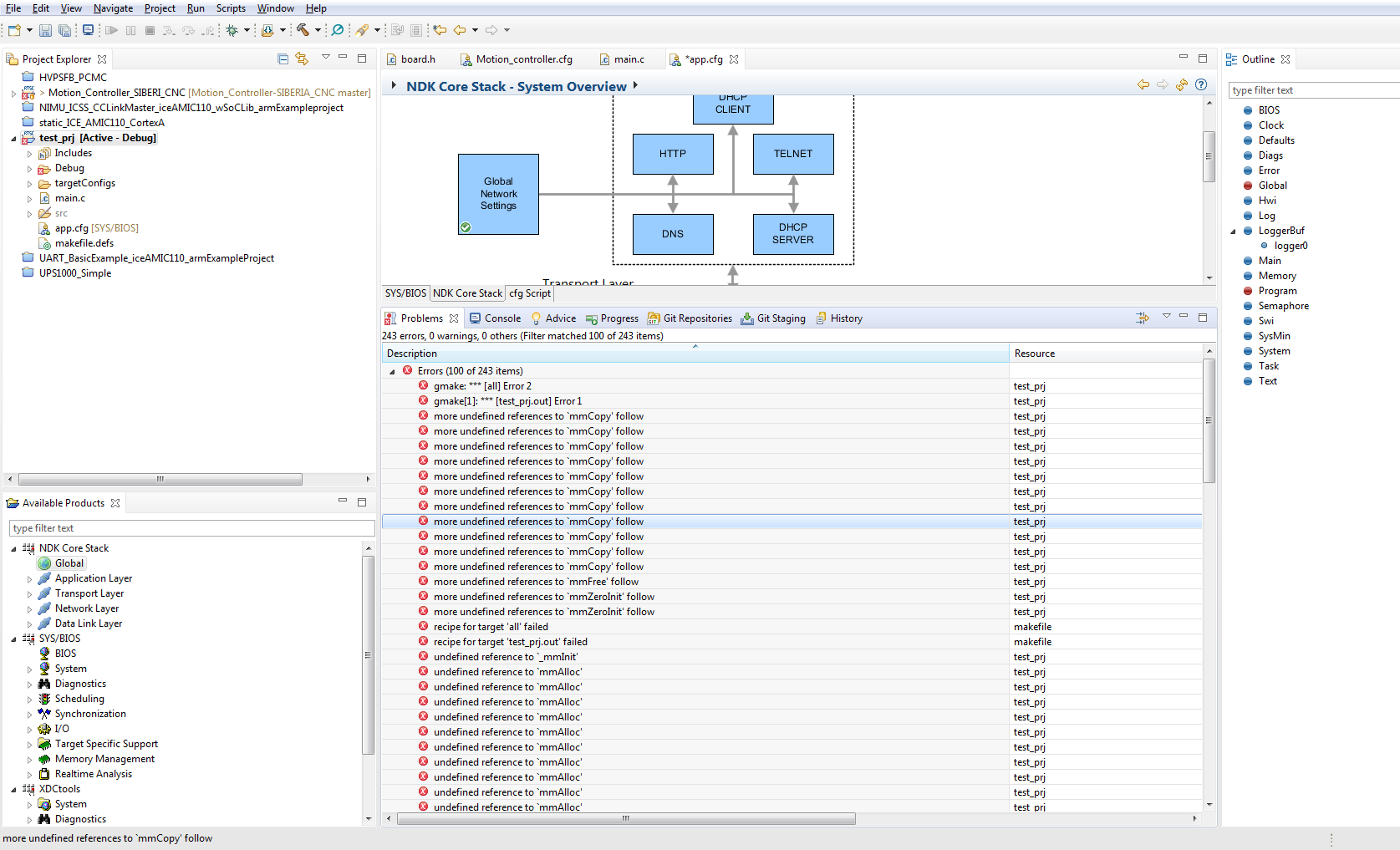

Hello.
When I'm create a new project with NDK and check Global network settings, I have many error like mmCopy, mmInit, mmAlloc and e.g.
Based on the documentation, this is related to the stack, but I can not figure out where to set it up.
Tell me how to solve this problem.

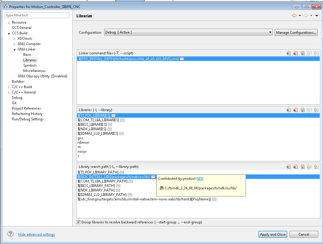

  • Hi Kiselev,
    These memory operation functions are from ndk_2_26_00_08\packages\ti\ndk\os\lib\os.aa8fg, do you have ${NDK_INSTALL_DIR}/packages/ti/ndk/os/lib in your Library search path?
    Garrett

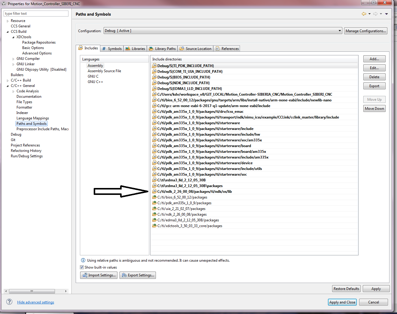

  • Hi Garrett.
    I haven't that include path in my project . I added ${NDK_INSTALL_DIR}/packages/ti/ndk/os/lib but situation  is not changed. In the picture below I showed how the path was added.

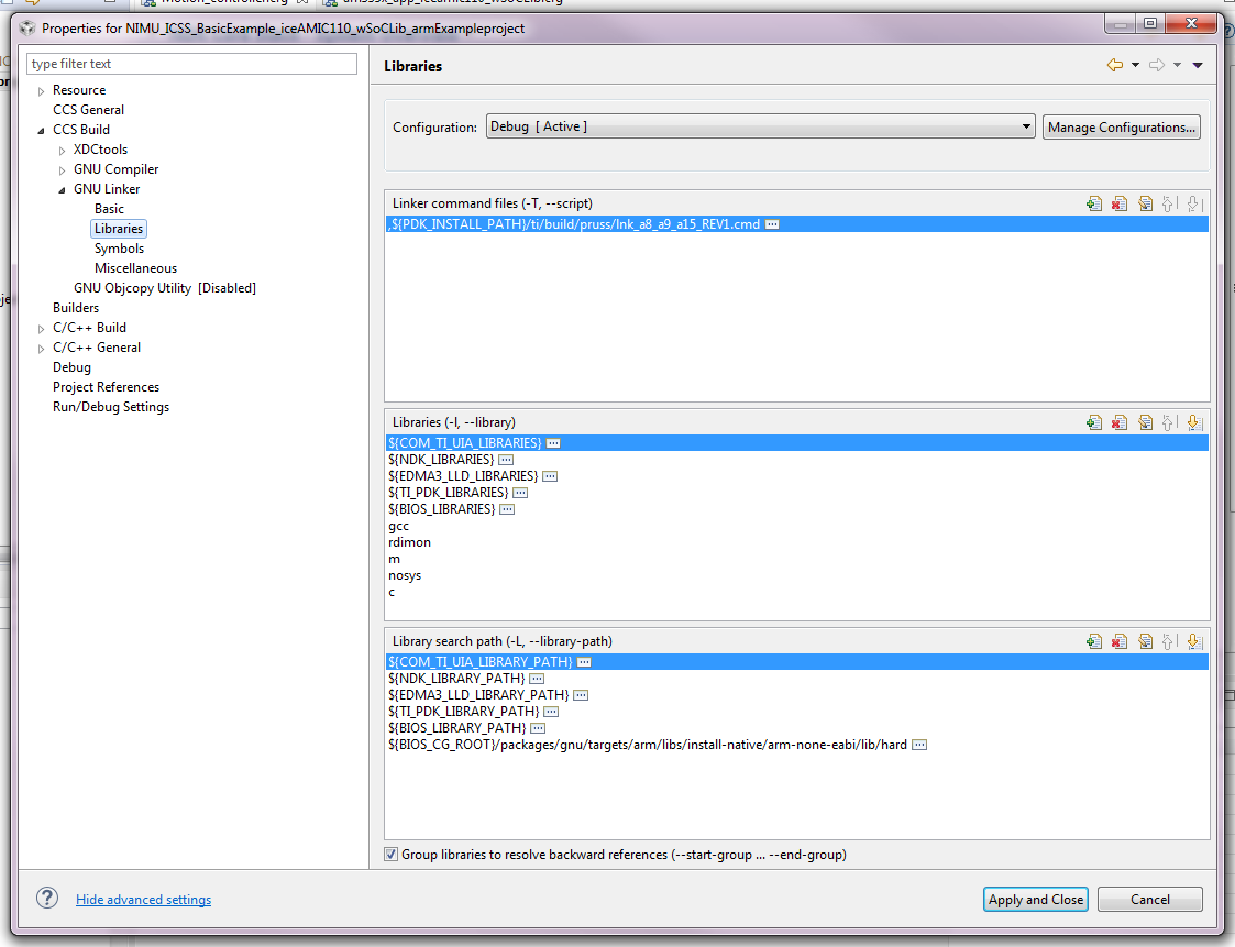

  • Hi Kiselev,
    Have you checked if the path is also in GNU Linker - >Library search path? Alternatively you can upload your build log, so we can check if it's missing.
    Garrett

  • Have an idea, what is wrong?
  • Kiselev,
    Can you try to add '${NDK_INSTALL_DIR}/packages/ti/ndk/os/lib' in your Library search path? so the build log should have -L"C:/ti/ndk_2_26_00_08/packages/ti/ndk/os/lib? You can refer to the example NIMU_BasicExample_evmAM335x_armExampleproject to see linker configuration.
    Garrett
  • Hi, Garrett.
    I added the path to the library as you specified. The result of the compilation did not change
    Also I carefully studied the settings of the project NIMU_ICSS_BasicExample_iceAMIC110_wSoCLib_armExampleproject and transferred them to my project, but the compilation of my project gives an error, and the compilation of the project NIMU_ICSS_BasicExample_iceAMIC110_wSoCLib_armExampleproject is successful.
    I no longer have any idea how to set up my project. It may be necessary to connect the compilation rule file, if any.
  • For example, this screen of the TI example, which I used as an example. And it have not ${NDK_INSTALL_DIR}/packages/ti/ndk/os/lib.
    How TI example find the required libraries, if they are specified implicitly.
