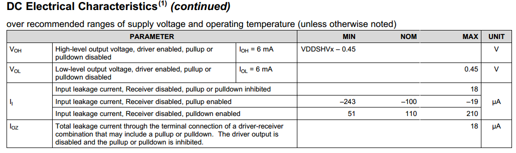

We want to use a external resistor to pull up the IO of am3352.
But we can't decide which value of resistor can been used, could you please help to find what it the maximum input current of I/O?
Like: LCD_PCLK,LCD_VSYNC,GPMC_CS,GPMC_AD....
thanks!
