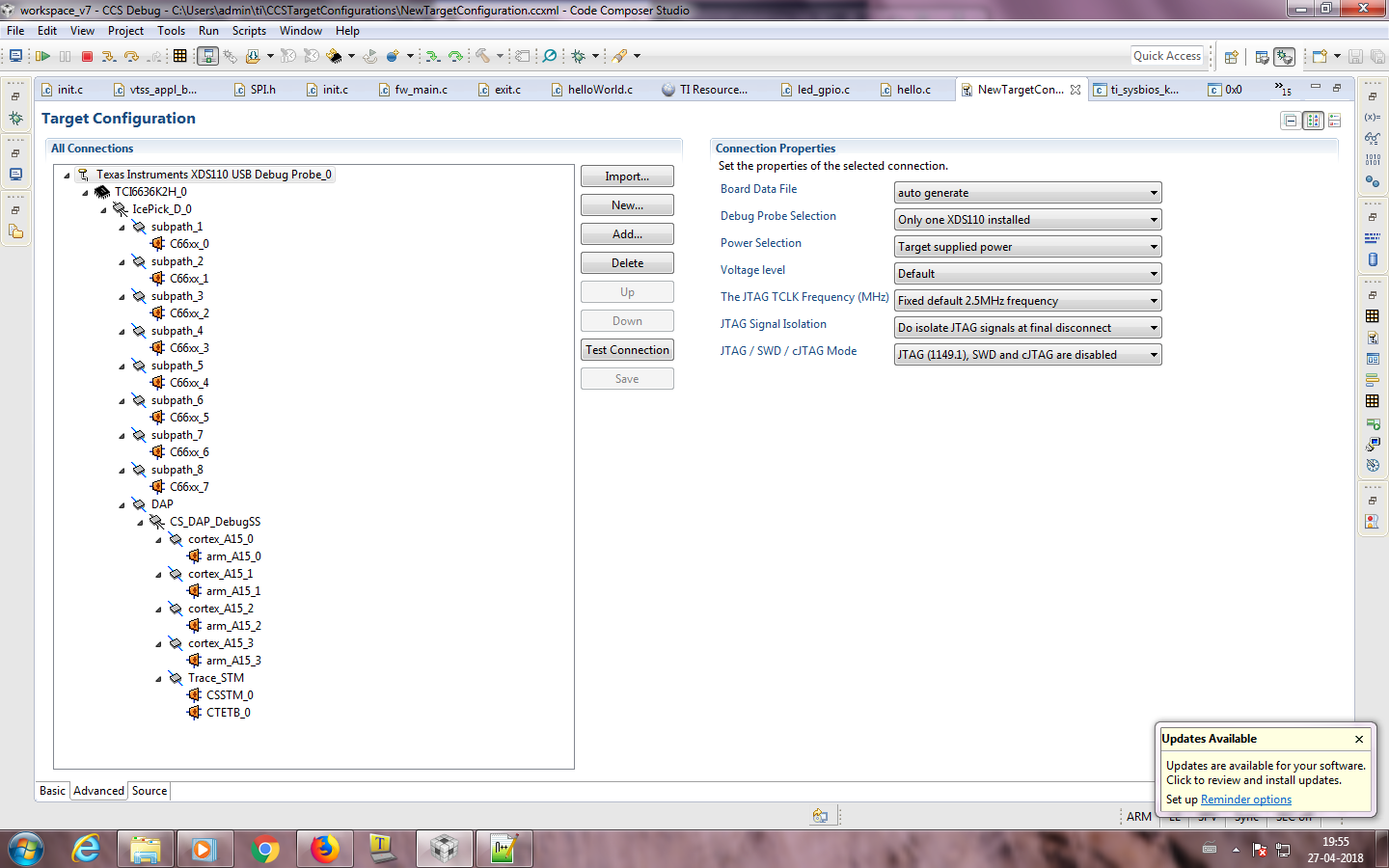

Hi
We have designed  customized  board  using 66AK2H14. We are using CCSV7 and ti-processor-sdk-rtos-k2hk-evm-04.01.00.06.
we are using TI XDS 110 debug probe .
this is our target configuration.
and we are using C:\ti\ccsv7\ccs_base\emulation\boards\xtcievmk2x\gel gel files .

    When you create the target configuration file, can you try selecting the 66AK2H12 device instead of TCI6636K2H?
    Yordan
  • Hi Yordan,
    I tried with 66AK2H12 but It gave me same error.

    Q1. how to solve Trouble Writing Memory Block at 0x80000000 on Page 0 of Length 0x4 for ARM core.
    Q2. We are using same DDR3 for ARM and DSP then why it is giving error for ARM , Timing values are same for both the cores in GEL file.
    Q3. Is there any other configuration for ARM core?
    Please help me with this.
    Thank you,
    Mahima Shanbag
