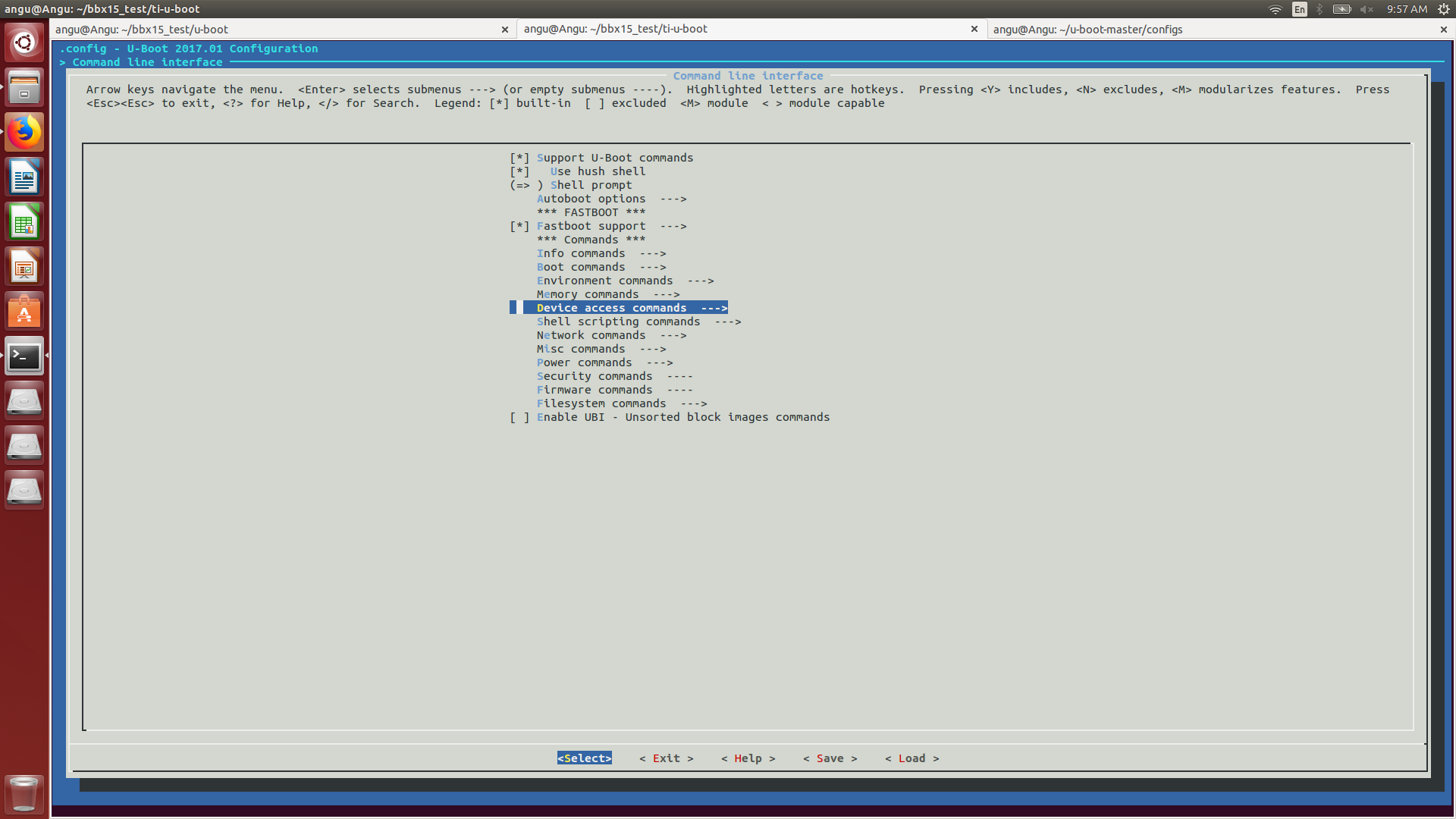

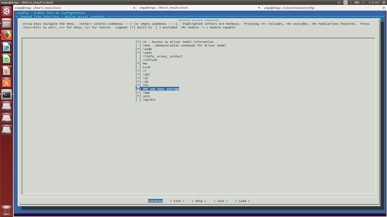

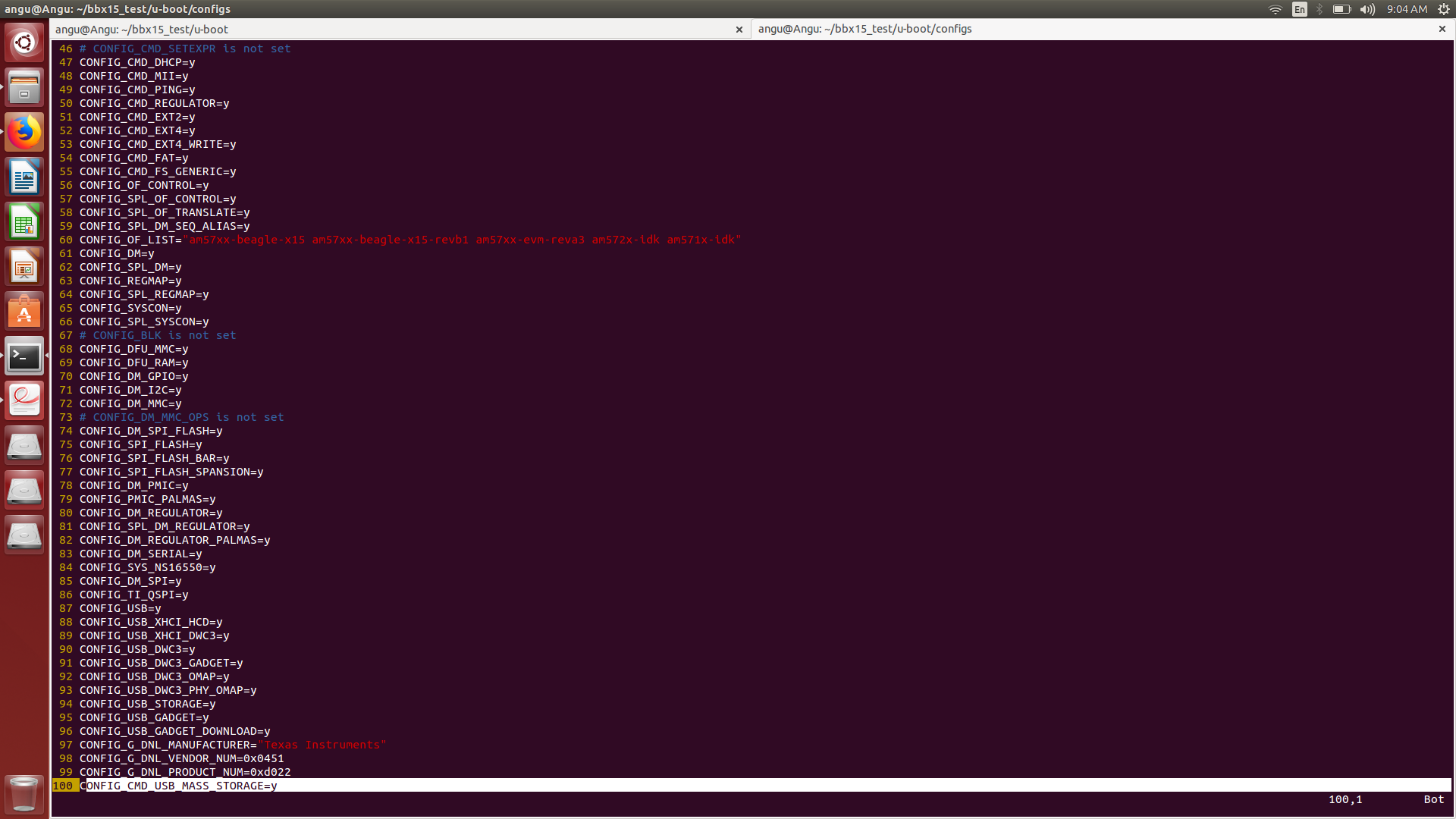

Hi iam using BeagleBoard-X15 in that u-boot command like UMS and TFTP is not there in my board. There is any patches available for enable those commands or any compilation mistake iam doing
I am following this link only

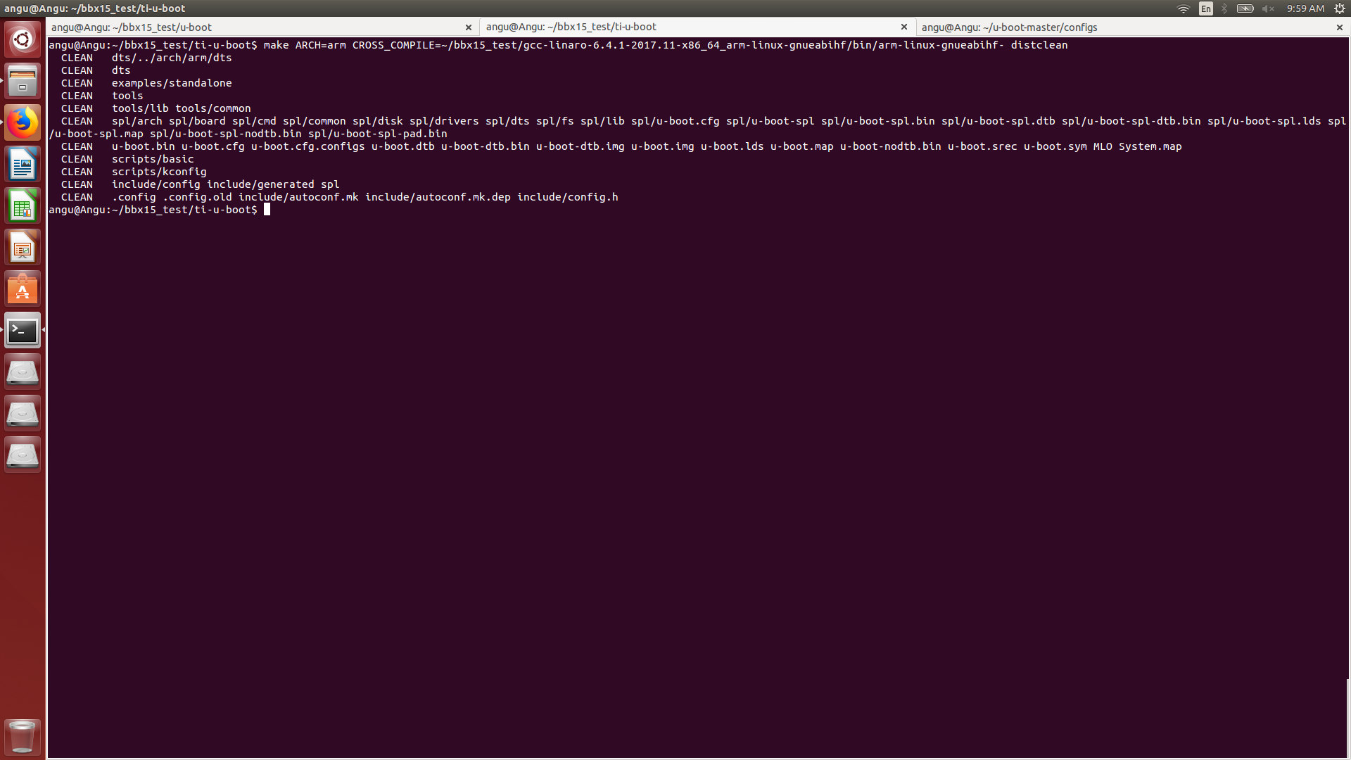

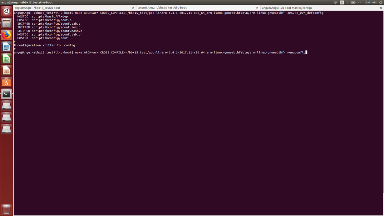

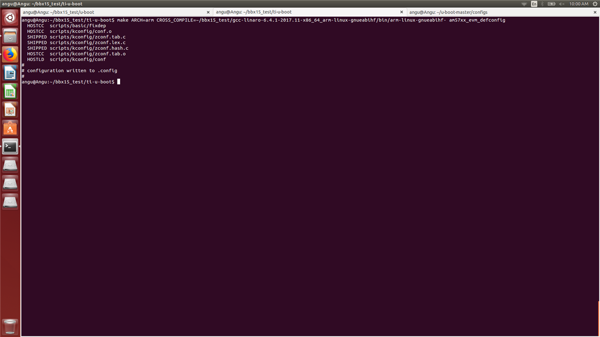

M sriramdhivakar said:1) git clone github.com/.../u-boot
2) cd u-boot/
3) git checkout v2017.01 -b tmp
From this step below onwards iam facing problem : site reply that unexpected fault is happen in server like that...
4) git pull --no-edit git://git.ti.com/ti-u-boot/ti-u-boot.git ti-u-boot-2017.01
5) git checkout 590c7d7fe15d06a4d708403d3234bcd01cd039e1
6) wget -c rcn-ee.com/.../0001-beagle_x15-uEnv.txt-bootz-n-fixes.patch
7) patch -p1 < 0001-beagle_x15-uEnv.txt-bootz-n-fixes.patch
8) make ARCH=arm CROSS_COMPILE=${CC} distclean
9) make ARCH=arm CROSS_COMPILE=${CC} am57xx_evm_defconfig
10) make ARCH=arm CROSS_COMPILE=${CC}
