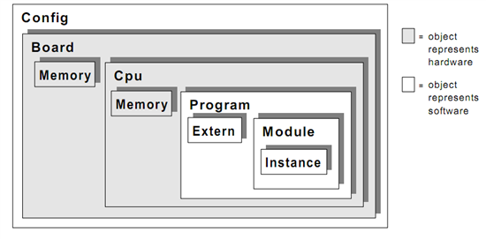

I have seen the pdf named "spru007h". It is about DSPBIOS 5.30 Textual Configuration. I have a question.
I read something about TCOM. Look at this picture
It only tell me something about the relationship between them, the properties and the methods of each part in the pdf.
Can you tell me something details about the TCOM??
  • Chapter "Tconf Object Model Reference" in spru007 is the most detailed description of TCOM available. As you said, it describes properties and methods of each object, as well as its purpose. Please let me know if you have any specific questions about Tconf and TCOM.
    The main purpose of Tconf is to enable configuration of applications using DSP/BIOS. For such users, the most important classes of objects are Modules and Instances created by DSP/BIOS, and these are described in a DSP/BIOS User's Guide for a specific processor family. For example, C6000 DSP/BIOS User's Guide is spru403.
