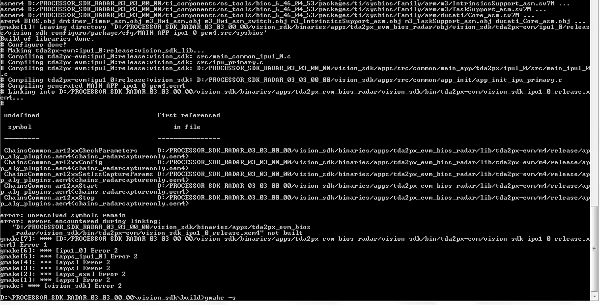

     I am trying to build the application using the steps mentioned in ProcessorSDKRadar_UserGuide.pdf for TDA2x+. I am using AWR1243 sensor with TDA2x+. Why the steps  related to changes need to be made for TDA2px in the 3.2 step of the document are not mentioned?  If I make the following changes in the Rules.make file present in the build directory of visionsdk.
MAKECONFIG?=tda2px_evm_bios_radar
& execute gmake command to build application after setting the correct XDC path, I encounter the following error:
D:/ProcessorSDK_Radar_3_1_0_0/vision_sdk/apps/configs/cfg.mk:21: D:/ProcessorSDK_Radar_3_1_0_0/vision_sdk/apps/configs/tda2px_evm_bios_radar/cfg.mk: No such file or directory
gmake: *** No rule to make target `D:/ProcessorSDK_Radar_3_1_0_0/vision_sdk/apps/configs/tda2px_evm_bios_radar/cfg.mk'. Stop.
And there is no file related to TDA2px at the location: D:\ProcessorSDK_Radar_3_1_0_0\vision_sdk\apps\configs.
Did I miss any step while installation or is there something which needs to be installed for TDA2px?

    As I said earlier, I m trying to build the sample application for TDA2px. As per the Userguide , I have modified the required changes in the Rules.make file
    When executed the "gmake -s -j depend " i encounter the following errors (gmake Error 2).I have pasted them all in a attached text file. Also executed the
    "gmake -s showconfig" command to list all the configurations. Am I supposed to perform any other modifications?
    Thanks in advance.

    >> ERROR: cannot run D:\PROCESSOR_SDK_RADAR_03_03_00_00\ti_components\cg_tools\windows\ti-cgt-arm_16.9.2.LTS\bin\armacpia.exe - invalid argument mode
    gmake[4]: *** [D:/PROCESSOR_SDK_RADAR_03_03_00_00/vision_sdk/binaries/apps/tda2px_evm_bios_radar/ti/drv/vps/src/devices/obj/tda2px/m4/release/bspdrv_i
    mx224Reg_30fps_Linear.oem4] Error 1
    gmake[4]: *** Waiting for unfinished jobs....
    # Archiving tda2px-evm-radar:tda2px:ipu1_0:release:vps_examples_utility into D:/PROCESSOR_SDK_RADAR_03_03_00_00/ti_components/drivers/pdk_01_09_00_17/
    packages/ti/drv/vps/lib/tda2px-evm-radar/m4/release/vps_examples_utility.aem4 ...
    # Archiving tda2px:ipu1_0:release:pm_lib into D:/PROCESSOR_SDK_RADAR_03_03_00_00/ti_components/drivers/pdk_01_09_00_17/packages/ti/drv/pm/lib/tda2px/m
    4/release/pm_lib.aem4 ...
    # Archiving tda2px:ipu1_0:release:pm_lib_optimized into D:/PROCESSOR_SDK_RADAR_03_03_00_00/ti_components/drivers/pdk_01_09_00_17/packages/ti/drv/pm/li
    b/tda2px/m4/release/pm_lib_optimized.aem4 ...
    # Archiving tda2px-evm-radar:tda2px:ipu1_0:release:vps_boards into D:/PROCESSOR_SDK_RADAR_03_03_00_00/ti_components/drivers/pdk_01_09_00_17/packages/t
    i/drv/vps/lib/tda2px-evm-radar/m4/release/vps_boards.aem4 ...
    # Archiving tda2px:ipu1_0:release:vpsdrv into D:/PROCESSOR_SDK_RADAR_03_03_00_00/ti_components/drivers/pdk_01_09_00_17/packages/ti/drv/vps/lib/tda2px/
    m4/release/vpsdrv.aem4 ...
    # Archiving tda2px:ipu1_0:release:stw_platform into D:/PROCESSOR_SDK_RADAR_03_03_00_00/ti_components/drivers/pdk_01_09_00_17/packages/ti/drv/stw_lld/p
    latform/lib/tda2px/m4/release/stw_platform.aem4 ...
    # Archiving tda2px:ipu1_0:release:vpslib into D:/PROCESSOR_SDK_RADAR_03_03_00_00/ti_components/drivers/pdk_01_09_00_17/packages/ti/drv/vps/lib/tda2px/
    m4/release/vpslib.aem4 ...
    # Archiving tda2px:ipu1_0:release:csl into D:/PROCESSOR_SDK_RADAR_03_03_00_00/ti_components/drivers/pdk_01_09_00_17/packages/ti/csl/lib/tda2px/m4/rele
    ase/ti.csl.aem4 ...
    # Archiving tda2px:ipu1_0:release:pm_hal_optimized into D:/PROCESSOR_SDK_RADAR_03_03_00_00/ti_components/drivers/pdk_01_09_00_17/packages/ti/drv/pm/li
    b/tda2px/m4/release/pm_hal_optimized.aem4 ...
    # Archiving tda2px:ipu1_0:release:pm_hal into D:/PROCESSOR_SDK_RADAR_03_03_00_00/ti_components/drivers/pdk_01_09_00_17/packages/ti/drv/pm/lib/tda2px/m
    4/release/pm_hal.aem4 ...
    gmake[3]: *** [vps_devices] Error 2
    gmake[2]: *** [pdk] Error 2
    gmake[1]: *** [pdk] Error 2
    gmake: *** [depend] Error 2

    I have then executed the command once again and was luckily done with no errors. I don't know exactly what was the problem before. But that case was just for the single radar use case (enabled by default was "radar_read_fft_write"). I wanted to add one more use case and i have made the respective changes in uc_cfg.mk file.
    And now, for "gmake -s -j" command I get various undefined symbol errors as listed:
    undefined first referenced
    symbol in file
    ChainsCommon_ar12xxConfig D:/PROCESSOR_SDK_RADAR_03_03_00_00/vision_sdk/binaries/apps/tda2px_evm_bios_radar/lib/tda2px-evm/m4/release/app_alg_plugins.aem4<chains_multiradarcapturefftdisplay.oem4>
    ChainsCommon_ar12xxSetIssCaptureParams D:/PROCESSOR_SDK_RADAR_03_03_00_00/vision_sdk/binaries/apps/tda2px_evm_bios_radar/lib/tda2px-evm/m4/release/app_alg_plugins.aem4<chains_multiradarcapturefftdisplay.oem4>
    ChainsCommon_ar12xxStart D:/PROCESSOR_SDK_RADAR_03_03_00_00/vision_sdk/binaries/apps/tda2px_evm_bios_radar/lib/tda2px-evm/m4/release/ap
    ChainsCommon_ar12xxStop D:/PROCESSOR_SDK_RADAR_03_03_00_00/vision_sdk/binaries/apps/tda2px_evm_bios_radar/lib/tda2px-evm/m4/release/ap
    I don't know where I am wrong.
    Varsha
  • Hi Varsha,
    When you call gmake using -j multiple build processes are invoked. Due to this dependencies might not get calculated correctly. This depends on the build machine as well.
    Similar to previous command you should do a "gmake -s". I would suggest you not to use -j on your PC while building any executable in general.
    Rishabh

    There are multiple issues here.
    You should do "gmake --help" to understand the option "-j" and comprehend why the build failed first time and succeeded second time.
    Also you should build dependencies again when you are making changes to uc_cfg.mk.
    Best is to do a clean build for both dependencies as well as Vision SDK.
    Rishabh
     I have tried again by doing clean build, but unable to resolve those issues. Attaching the screenshot of the gmake errors. For this attempt, I removed -j option , hence my command is "gmake -s".  Can you please help me to figure out these undefined symbol errors. Here, I have added one more usecase(radar_capture_only usecase) with the one which was already present(radar_read_fft_write) in uc_cfg.mk file. Is there any other file which needs to be modified after adding any new usecase?
    Thanks in advance.
    Regards,                                                                                                                                                                                                                                                        Varsha
  • Hi Varsha,
    There is only use case that is supported on TDA2Px i.e. UC_radar_read_fft_write using network and SD card.
    UC_radar_capture_only is supported for TDA3xx.
    Can you let us know what exactly are you trying and what is the setup you have.
    Rishabh
  • Hi ,
    I am trying to build the already existing usecases present in the usecases folder of radar SDK. My setup is AWR1243 and TDA2px.
    Among all the usecases, is that the case UC_radar_read_fft_write is only supported for TDA2px and UC_radar_capture_only is the only one supported for TDA3xx ?
    Thanks & regards,
    Varsha
    This is correct. UC_radar_capture_only is not supported on TDA2Px.
    Only UC_radar_read_fft_write is supported on TDA2Px.
    Rishabh
