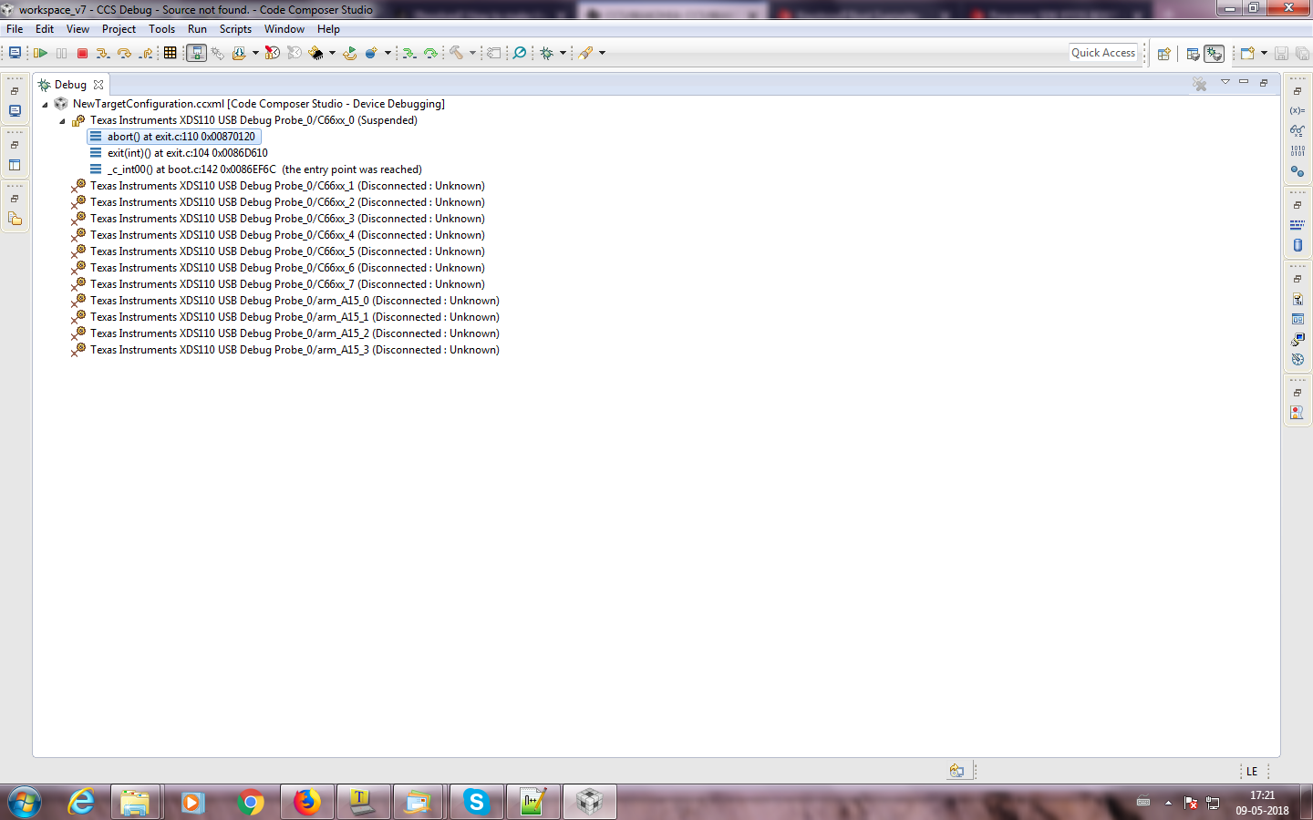

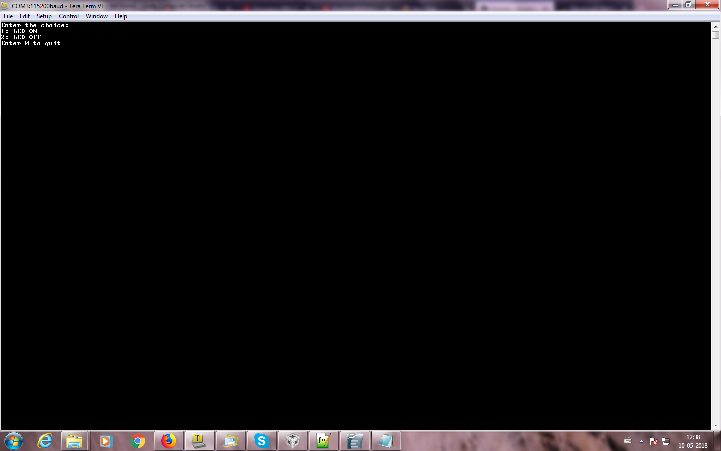

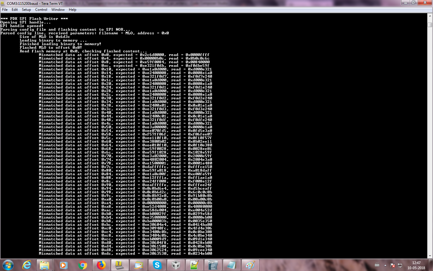

  • Hi Yordan,
    I tried with pre built images of processor_sdk_rtos_k2hk_4_03_00_05 but it was getting aborted.
    Even I tried  sbl/flash_writer but there also same issue.
    In both the case it was getting aborted at UART_printf.
    I try to rebuild flash writer but I was not able to import it in CCS.
    So Please suggest any alternative method to solve this issue.

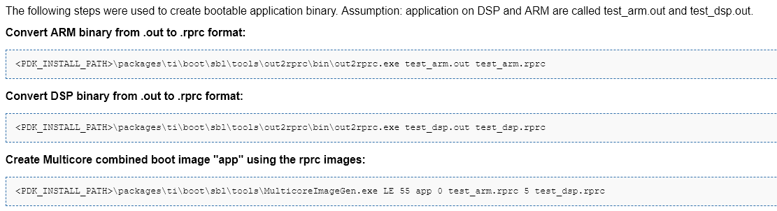

  • Mahima,
    Please note that K2HK is an ARM master boot device and not a DSP boot master device so the steps for creating .dat file using hex6x don`t directly apply here.
    Technically DSP bootloader is also provide for legacy users but since this is considered a multicore ARM boot device, majority of the use case have been validated with ARM as the boot master. Check the E2E discussion here:
    e2e.ti.com/.../606407
    You need to determine whether you want to boot your application using ROM bootloader or user level secondary bootloader and then determine the approach to create the boot image. Also, you need to start testing the boot on TI EVM before migrating to the custom board which may have different clocks, UART instances and DDR memory.
    Can you answer the following questions so that we can best help you:
    1. Do you want to use direct ROM boot or SDK provided secondary bootloader to boot your application. the currently official supported approach in the RTOS SDK is using Secondary bootloader that is booted by the ROM then sets up DDR, clocks, and loads the application into full SOC address space and then wakes up the slave cores to start executing code. ARM And DSP image can be loaded using this approach into MSMC an/or DDR memory.
    The SBL for K2H SPI NOR is documented here:
    This uses out2rprc and multicoreImageCreate utilities for creating the boot image for SPI.  Attached is the boot log from the system test team for Processor SDK RTOS 4.03 that tested the SBL boot for K2HK platform:
    *** PDK SPI Flash Writer ***
    Opening SPI handle...
    SPI handle opened!
    Parsing config file and flashing content to SPI NOR...
    Parsed config line, received parameters: filename = MLO, address = 0x0
    	Size of MLO is 0x7200
    	Loading binary to memory ...
    	Finished loading binary to memory!
    	Flashed MLO to offset 0x0!
    	Read flash memory at 0x0, checking flashed content...
    	Verified flash data equal expected data!
    Parsed config line, received parameters: filename = app, address = 0x80000
    	Size of app is 0x16e64
    	Flashed app to offset 0x80000!
    	Read flash memory at 0x80000, checking flashed content...
    Successfully flashed memory content!

    2. Can you confirm that when creating the boot image you used the following steps:
    3. Have you tested your bootimage on the TI EVM ? Are you seeing the same issue? If yes, then we can try to reproduce the issue at our end and provide guidance on fixing the issue.
    4. Have you tried the debugging steps provided here:
    processors.wiki.ti.com/.../Processor_SDK_RTOS_Boot
    Rahul

    I followed the same steps as u have mentioned like
    out2rprc.exe hello_66AK2H12_C66XX.out gpio_app
    MulticoreImageGen.exe LE 55 app 0 gpio_app

    Yeah, I have tested it on EVM .
    When I run the Application through JTAG I was getting prints on Tera Term.
    but When I flash it through C:\ti\pdk_k2hk_4_0_7\packages\ti\boot\writer\nor it was flashing successfully , didnt get any prints when I change the boot mode to SPI.
    I try to flash same image with flash_writer utility and I got below log

  • Mahima,
    you have created an DSP application but have made the error while creating the Multicore boot image. The COREID for the DSP is 5 and you have used 0. Core ID 0 corresponds to A15 core0 hence the bootloader will try to run that code on the A15.
    MulticoreImageGen.exe LE 55 app 5 gpio_app
    I also recommend not mixing SPI writers from mcsdk and Processor SDK. IF you are building the images using Processor SDK RTOS then we recommend that you use the flash writer from the same release as that is what our system test team uses for validation.
    If you want us to reproduce and provide a working bootimage, then I would recommend that you zip your binary and provide it here. Please account for some delays in turn around time because we are helping multiple customers and may take some time to get to this issue on K2H EVM
