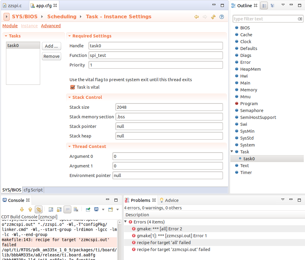

Hi TI,
   beaglebone black, processor SDK RTOS 4.2.0.9, ccs 7.4
I am working on SPI data transfer with TI-RTOS on BBB board, and seeing the following codes in the example project main() function.
    Task_Handle task;
    Error_Block eb;
    Error_init(&eb);
    task = Task_create(spi_test, NULL, &eb);
    if (task == NULL) {
        UART_printf("Task_create() failed!\n");
        BIOS_exit(0);
I expect the above codes are equivalent to the definition of task0 in app.cfg (ref the attached screen-shot below), and I commented out the above codes in the main() function. Obviously they are different. The compile error message did not reveal too much useful information (also shown on the screen-shot).
Please advise, thanks in advance,

  • **** Build of configuration Debug for project zzmcspi ****
    /opt/ti/ccsv7/utils/bin/gmake -k -j 4 all -O
    making ../src/sysbios/sysbios.aa8fg ...
    Building file: "../app.cfg"
    Invoking: XDCtools
    "/opt/ti/xdctools_3_50_04_43_core/xs" --xdcpath="/opt/ti/RTOS/bios_6_52_00_12/packages;/opt/ti/RTOS/edma3_lld_2_12_05_30B/packages;/opt/ti/RTOS/ndk_2_26_00_08/packages;/opt/ti/RTOS/pdk_am335x_1_0_9/packages;/opt/ti/ccsv7/ccs_base;" xdc.tools.configuro -o configPkg -t gnu.targets.arm.A8F -p ti.platforms.beaglebone -r release -b "/opt/ti/RTOS/pdk_am335x_1_0_9/packages/ti/build/am335x/config_am335x_a8.bld" -c "/opt/ti/ccsv7/tools/compiler/gcc-arm-none-eabi-6-2017-q1-update" -DBOARD=evmAM335x "../app.cfg"
    gmake[1]: Nothing to be done for 'all'.
    configuring app.xa8fg from package/cfg/app_pa8fg.cfg ...
    generating custom ti.sysbios library makefile ...
    	Linking with library ti.drv.uart:./lib/am335x/a8/release/ti.drv.uart.aa8fg
    	Linking with library ti.board:./lib/bbbAM335x/a8/release/ti.board.aa8fg
    	Linking with library ti.drv.i2c:./lib/am335x/a8/release/ti.drv.i2c.aa8fg
    	Linking with library ti.drv.spi:./lib/am335x/a8/release/ti.drv.spi.aa8fg
    	Linking with library ti.csl:./lib/am335x/a8/release/ti.csl.aa8fg
    	Linking with library ti.osal:./lib/tirtos/a8/release/ti.osal.aa8fg
    Starting build of library sources ...
    making /home/michael/Desktop/rtosgpib/zzmcspi/src/sysbios/sysbios.aa8fg ...
    gmake[1]: Entering directory `/home/michael/Desktop/rtosgpib/zzmcspi/src/sysbios'
    gmake[1]: Nothing to be done for `all'.
    gmake[1]: Leaving directory `/home/michael/Desktop/rtosgpib/zzmcspi/src/sysbios'
    Build of libraries done.
    cla8fg package/cfg/app_pa8fg.c ...
    Finished building: "../app.cfg"
    gmake[2]: Nothing to be done for 'all'.
    Building target: "zzmcspi.out"
    Invoking: GNU Linker
    "/opt/ti/ccsv7/tools/compiler/gcc-arm-none-eabi-6-2017-q1-update/bin/arm-none-eabi-gcc" -mtune=cortex-a8 -marm -Dam3359 -DSOC_AM335x -DbbbAM335x -DMCSPI_MASTER_TASK -g -gdwarf-3 -gstrict-dwarf -Wall -mfloat-abi=hard -Wl,-Map,"zzmcspi.map" -nostartfiles -static -Wl,--gc-sections -L"/opt/ti/RTOS/bios_6_52_00_12/packages/gnu/targets/arm/libs/install-native/arm-none-eabi/lib/hard" -L"/opt/ti/RTOS/bios_6_52_00_12/packages/gnu/targets/arm/libs/install-native/arm-none-eabi/lib/hard" -Wl,--defsym,STACKSIZE=0x1C000 -Wl,--defsym,HEAPSIZE=0x400 --specs=nano.specs -o"zzmcspi.out" "./zzspi.o" -Wl,-T"configPkg/linker.cmd" -Wl,--start-group -lrdimon -lgcc -lm -lc -Wl,--end-group
    makefile:143: recipe for target 'zzmcspi.out' failed
    /opt/ti/RTOS/pdk_am335x_1_0_9/packages/ti/board/lib/bbbAM335x/a8/release/ti.board.aa8fg(bbbAM335x_lld_init.oa8fg): In function `Board_uartStdioInit':
    bbbAM335x_lld_init.c:(.text.Board_uartStdioInit+0x10): undefined reference to `UART_stdioInit'
    collect2: error: ld returned 1 exit status
    gmake[1]: *** [zzmcspi.out] Error 1
    gmake: *** [all] Error 2
    makefile:139: recipe for target 'all' failed
    **** Build Finished ****

  • Hi Rahul,
    I solve the puzzle by myself.
    In .cfg file, uart should be defined before loading the board package. Then everything works like a charm.
    /* Load the uart package */
    var socType          = "am335x";
    var Uart              = xdc.loadPackage('ti.drv.uart');
    Uart.Settings.socType = socType;
    /* Load the board package */
    var Board = xdc.loadPackage('ti.board');
    Board.Settings.boardName = "bbbAM335x";
    Thank you for the help
