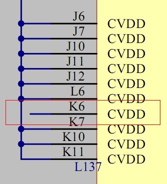

  • I'm sorry for didn't  replying your post,beacause I am so busy these days.
    Finally,we found the problem,as the picture says:
    the PSC is related to all the CVDDs,and I didn't connect K6.
    It's my responsibility.
    Is there any remedial measures to solve this problem,and does this one of the CVDDs decided we can't use PSC anymore?
    thanks to you all.
  • Hi
    It is important that you have all the CVDD pins connected to power/1.2V. Failing to do this could cause unexpected behavior.
    Power Sleep Controller (PSC) manages clocks to various modules most of which are powered by CVDD, not having the power pins connected can definitely cause issues as enabling/disabling clocks goes through a internal negotiation protocol with the various peripherals, to ensure they are in good state.The hang on the poll for status would indicate some unexpected issues while transitioning from disable to enable state , and it could be related to this unconnected power pin.
    We would recommend fixing this board issue, as you could see issues even beyond PSC module.
    Mukul
