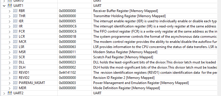

I'm running some test/basis code, which simply tries to regenerate a UART Rx interrupt, in response to an incoming Modbus poll message across the wire (8 bytes every 200 msec).  However, I only get one Rx interrupt, then no more, even though the UART registers imply that another interrupt is needed - LSR has the READY bit set, plus IIR indicates a PEND (either RLS or or RDA, depending on the run).  I clear out the event each time, in the UART interrupt, plus read the RBR, so that should set things up for the next interrupt?
extern "C" void hwi_fxn_uart( void )
( (evt_reg_1 *)ADDR_EVTCLR1 )->EVTCLR1 = EVT_EF_46;
uint8_t          buf = ( (uart_regs_t *)UART_1 )->RBR;
It's a sparse interrupt processing, because I'm simply trying to get to a point that the interrupt is generated each time, before putting in the post-processing.
Below is a picture of my UART-related register settings
Any ideas why the interrupt is not being re-generated, would be appreciated.
Robert

  • Your last screen capture has IER = 0x0D = 0000 1101, EDSSI = 1, ELSI = 1, TBEI = 0, ERBI = 1. I think EDSSI should be 0. Even though autoflow is not enabled, not sure if any glitch on the flow control pins would cause a flow control interrupt. You should check to see that you are not pinmuxing the flow control pins.
    I would suggest not using the emulator register display as that it itself causes reads of registers. For example using the display window will read the RBR twice in a row. The LSR changes as each RBR. Perhaps try using some more global counters to instrument it and break in and look at the counters when it hangs.
    Any reason why you are using a SWI rather than handling the UART interrupt right away?
    Seems like things went from partially working to not working at all. Maybe time to roll back to partially working.
    You should remove the resolved mark off my post. That might get more eyes on your problem. That's all I got.
    Never had that set, just did in the fog of all this debugging

  • I wasn't clearing out the MCR, flow control registers (AFE, RTS), but MCR was always 0 anyways.  I've put in explicit clears of those bits now, as part of start-up configuration.
    I got rid of the SWI, and am doing everything in the uart handler, and am getting further.  This code below appears to be running without stop, i.e. the interrupts are being constantly generated.

  • That's good you have something that's working now. It might be worth testing it overnight so we can be sure. Also, you should be leveraging the IIR register within the interrupt. Can you add some additional code to check that register?
