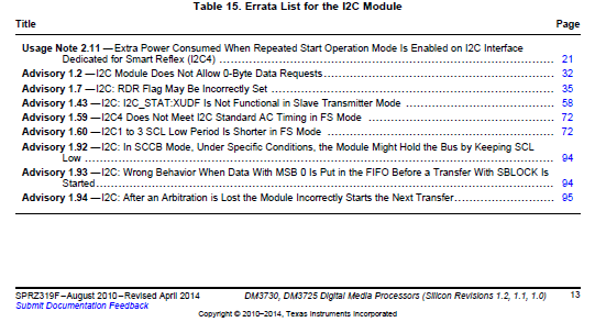

  • thanks Biser.
    I found this related document. Could the AM335x I2C block additionally be affected by any of the i2c errata listed here?
    http://www.ti.com/lit/er/sprz319f/sprz319f.pdf   - thanks. Paul.
  • This is a completely different device. AM335x Errata can be found here: www.ti.com/.../sprz360i.pdf
  • Indeed, but I believe we were previously referred to the DM37x I2C section of the spec when we spent time debugging the Sitara I2C back in 2016, which I why I linked this.
    So the I2C silicon is not related?
    The AM335x errata is not very detailed w.r.t I2C, I am not sure if that is because
    1) the same issues have not been checked there, or
    2) the AM335x is certified free of these defects.
    Which is the case?
    There are some very interesting errata there about :
    1.7 RDR may be incorrectly set
    1.43 XUDF not functional in Slave TX
    1.93 wrong behaviour ...SBLOCK
    1.94 After Arb loss, module incorrectly starts next transfer
    Now, as we ourselves found that the AM335x I2C block does not behave very well in multimaster, I want to know for certain that these errata DO NOT apply to the AM335x.
    Can you please check this with the design teams.
    FYR I need to get the I2C block working in master mode, where another HW may be performing slave operations (since the Sitara I2C slave does not seem to work = previous threads)
    but there seems to be some misbehaviour around Arb loss.
    Having some good detailed errata about everything that will be a hurdle would be a vital help.
    Can you also refer me to a more detailed description of how the SBLOCK should be used?
    best regards
    Paul
  • Hi Paul,
    The DM37x I2C errata are not known to apply to AM335x.
    Also, here's some additional details about SBLOCK. This feature offers the possibility for the Local Host to command the blocking of the I2C clock after the Address Phase, if the module is addressed by an external master using a certain address.
