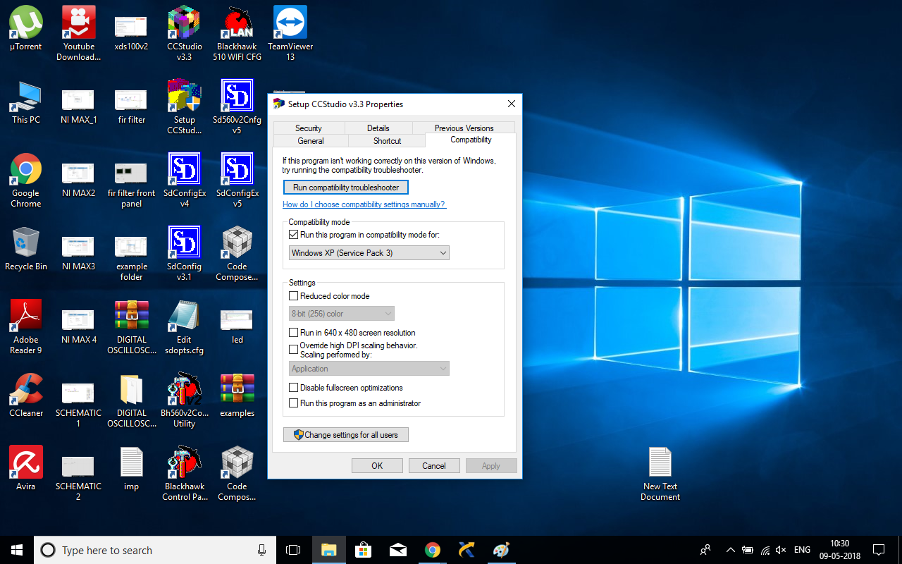

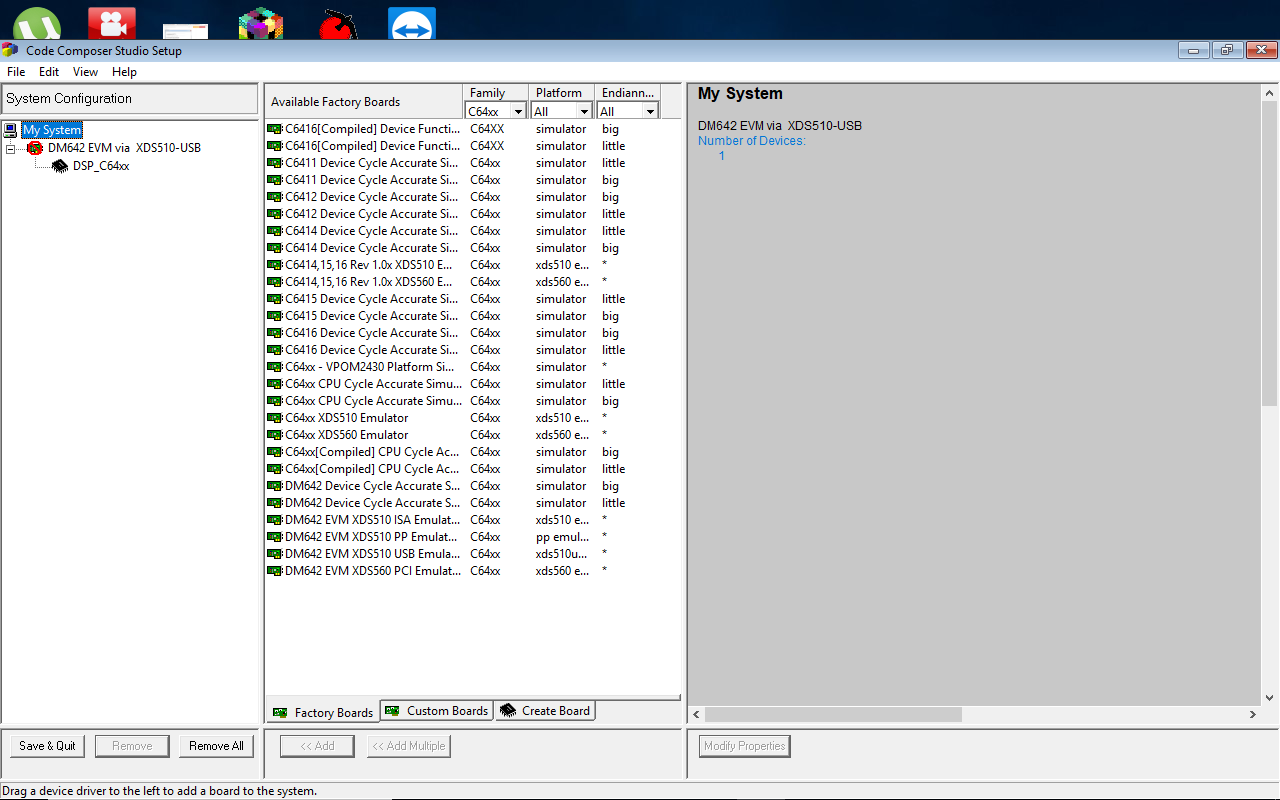

  • Hi JohnS,
    Yes I worked in admin mode.
    I have attached the error files. Kindly check and suggest.
  • That red circle and line through the board is definitely a problem. It has been years since I have used 3.x but I believe it means that some of the required components could not be loaded. I will have to see if I can dig up more info on that.
    When you run cc_setup can you also check that box to "Run this program as an administrator" at the bottom of your second screen capture.

    If you configure for one of the simulators listed in the middle pane of the setup program does it still show the red circle on the left? If not I think there is an issue with the installation of the Spectrum Digital drivers. There is more information on how to install the drivers here: support.spectrumdigital.com/.../

  • Yes I always open ccs setup in administrative mode.
    I have checked the above website and also did the same thing as mentioned. You can see in my previous post I have given the same link from where I got the DM642 drivers. But as in the website they mentioned that after connecting the emulator os will ask the path for the driver but in my case Windows didn't detect the emulator after connecting also.
    Apart from that in Windows 7 ultimate I did not get any red dot as it was in Windows 10 but when I opened ccs, target couldn't be connected message was displayed . It shows errors. During the time of installation of ccsv3. 3, I got two errors dpkiont and some other I did not remember exactly.
