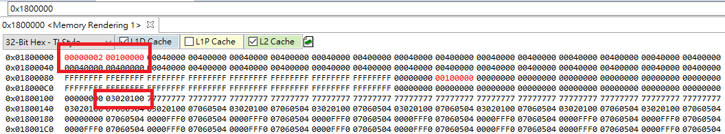

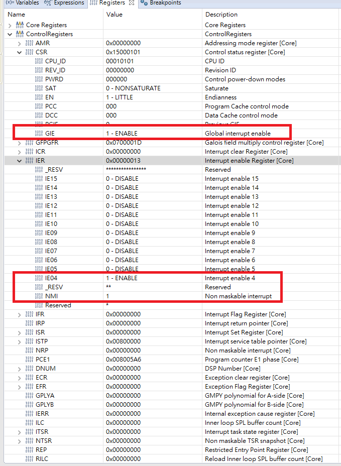

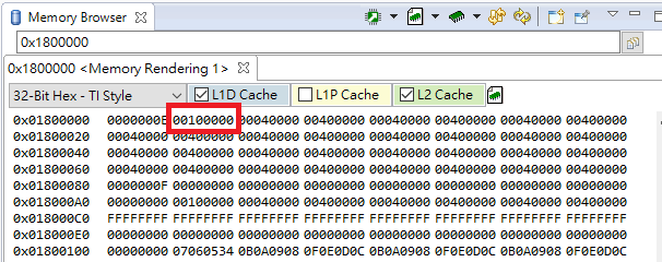

AM5728: Mailbox interrupt to DSP fails
Part Number: AM5728
I am trying to generate a interrupt from Mailbox1 to DSP1 on AM572X board, but the IFR doesn't change and my ISR doesn't be invoked when I push a message into MAILBOX1 by using command "devmem 0x4A0F4040 w 0x12345678" on CA15
I am sure that a interrupt is generated from MAILBOX1 (by checking MAILBOX_IRQSTATUS_CLR_u (0x4A0F0008)) and the C66X CorePac interrupt event NO. 52 bit is set (by checking interrupt event flag register (0x1800004)).
I have configured the following registers to map MAILBOX1_IRQ_USER0 to the CPUINT4 of DSP1.
  • CRS.GIE = 1
  • IER.IE4 = 1
  • IER.NMI = 1
  • INTMUX1.INTSEL4 = 52
  • CTRL_CORE_DSP1_IRQ_52_53[8:0] = 21 (by default)
  • MAILBOX_IRQENABLE = 0x05050505
Please give some suggestion!
Hungwei
The control registers are shown as follows.
The interrupt event flag register is shown as follows

    Yes. I am looking any functions which are used to control interrupt selector to map one of 128 interrupt events to one of DSPINT4 ~ 15. Could you help me?
    Hungwei
  • Hello Rahul,
    I have traced ti\csl\arch\c66x\src\interrupt.c and rewritten my program with CSL library. After I push data into the message queue0 of mailbox1. The event2 and event52 has been raised which is shown as the following figure, but IER[5].IE05 still remains 0. It seems that the interrupt still doesn't work. Please give some comments.
    Hungwei

    Thanks for your help. Now the C66x can receive interrupts from USER0 of Mailbox1. But I still have one question for you.
    From the TRM 17.3.2, MAILBOX1_IRQ_USER0 is mapped to DSP1_IRQ_52 after hardware reset. However, I need to add CSL_xbarIrqConfigure(...) to map DSP1_IRQ_52 to MAILBOX1_IRQ_USER0. Otherwise, the C66x will not process interrupt. Could you give some comment?
    CSL_xbarIrqConfigure(CSL_XBAR_IRQ_CPU_ID_DSP1, gXbarInst , CSL_XBAR_MAILBOX1_IRQ_USER0);
    Hungwei
