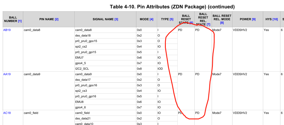

How should I set GPIO to high-impedence or tri-state on am4378?

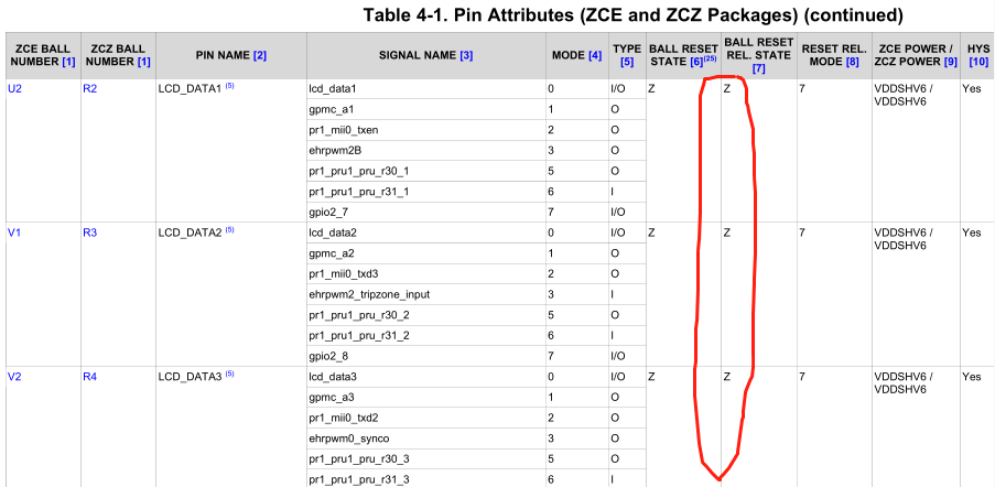

When I check am335x processor document: SPRS717J PIN Attributes chapter, it shows that IO is High-impedence as default as below. Also in am335x TRM Chapter9.3.1.50 conf_<module>_<pin>, it can enable/disable pin pullup/pulldown. But I cannot find this in am4378 TRM, also am4378 document SPRS851D shows Pullup/Pulldown as default after reset instead of high-impedence.
Then, I check Linux/Documentation/devicetree/bindings/pinctl/ti,iodelay-pinctl.txt, it has below example:
pinctl-single, pins = <
0x9c (PIN_INPUT_PULLUP | MANUAL_MODE | MUX_MODE1)
Then, I also cannot find about high-impedence or tri-state attributes settings in <TI PINMUX Tool>.
So can someone help me? thanks a lot. Looking forward for your reply.
