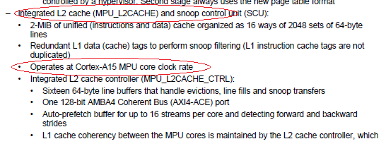

 ARM L1 : Width/Speed
 ARM L2 : Width/Speed

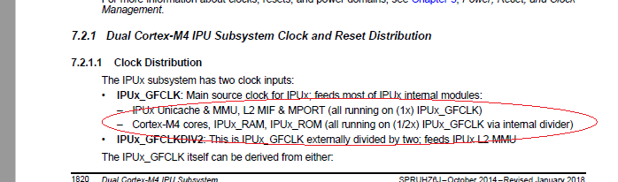

 IPU L1 : Width/Speed
 IPU L2 : Width/Speed
