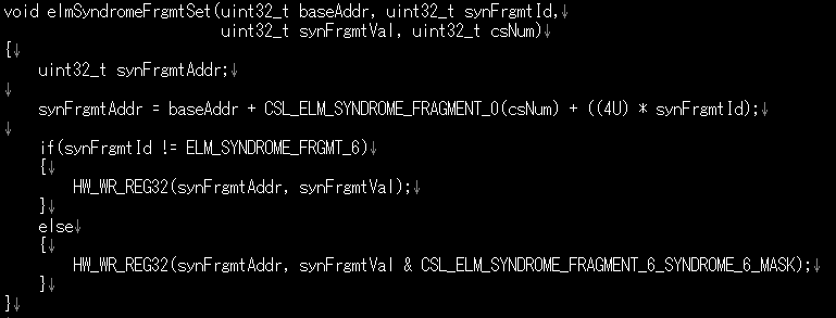

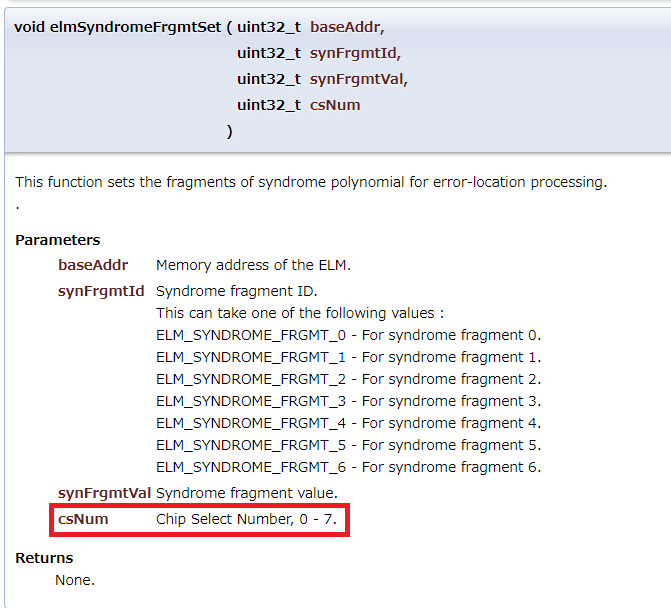

    For example, about the setting method of "ELM_SYNDROME_FRAGMENT_ 0 _ i" is described  in the API document of PDK as following.
    file:///C:/ti/pdk_am57xx_1_0_9/packages/ti/csl/docs/doxygen/html/elm_8h.html
    It seems that your document states that "i" specifies chip select. Is my understanding incorrect?

  • Sorry for the delayed reply here, I have confirmed what Steve has reported here: the csNum parameter for all the devices is set to 0. The CSL is generated from the original IP spec which seems to have provision for multiple chipselect but all sitara devices and K2G device that contains GPMC and ELM module supports only csNum=0.
    Rahul
  • Hi Rahul,
    It seems that "csNum" of CSL's ELM API indicates "i" of ELM registers as I mentioned earlier.
    Are you say that the NAND memory must be connected to the chip select 0 ( i = 0 ) for AM5726?
    H.U
