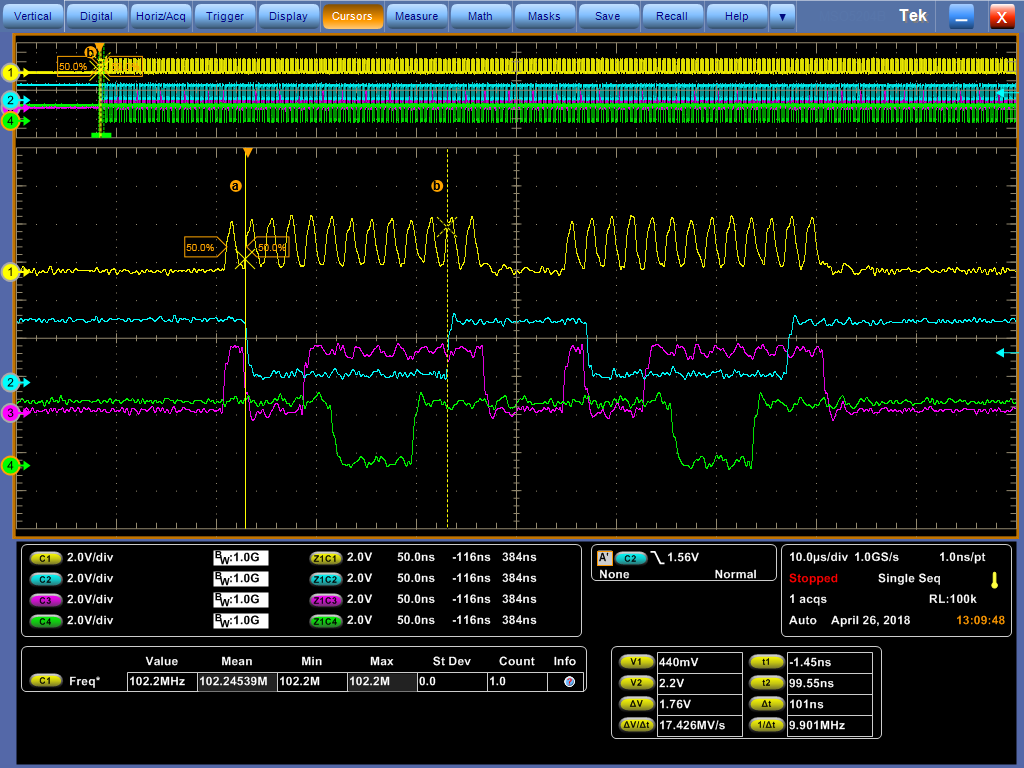

Our customers are attempting memory access of FPGAs using GPMC.
There is no problem with 1024 times Reading.
However, when Write is executed, it will be intermittently executed and will stop halfway.
(See attached file CH1: GPMC_CLK, CH2: CS, CH3: ADV, CH4: WE)
The setting is "Non Multiplexed, 16 bit, NOR, Synchronous".
The clock is 100 MHz.
The WAIT signal from the FPGA remains high.

    Try to relax the GPMC settings and see if the issue occurs again.
  • HI,
    They are experimenting with changing some patterns, but the situation does not seem to change.
    The next data is the timing that I made with reference to Figure 7-21 of TRM.

    Although this problem taked time, but it is not solved.
    Customer put a wait time at the time of writing.
    It means that this time was output at about 800nsec.
    void PioWrite(void)
    unsigned long i = 0;
    for (i = 0; i < 1024; i++)
    *(volatile unsigned long *)0x10000000 = 0;
    wait_process(); // wait about 800nsec
    However, this is too slowly and not practical.
    What is interfering with the output?
    Kouji Nishigata

  • HI,
    This problem is solved by setting the memory type to "strong order" in MMU.
    However, I thought that writing times are not omitted even in the case of device memory.
    Was this recognition wrong?
    Or is it a special case of writing the same data to the same address?
    Kouji Nishigata
  • Kouji,
    by setting the region as strongly ordered, they are essentially disabling the write buffering that the MMU could perform when the region was set to "device memory". All the writes should have been seen on the interface, but they would have probably come in bursts. In the case of strongly ordered memory, you would see all the writes as single accesses.
