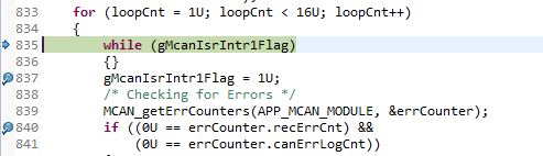

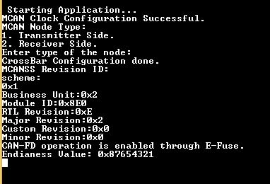

    We are following the steps you mentioned in previous post. However, when we select the EVM with Tx option as mentioned in step 3, it waits in while loop which checks for the normal operation of MCAN module at line 607 of "mcan_evm_loopback_app_main.c" as we stated in the first post.
    Attatching images of the UART prints when Tx option is selected and the screenshot of the while loop checking the mode of MCAN module for our reference.
    Example is continuously checks for the Normal mode of MCAN  module and is in the same while loop, so no transmission of messages takes place.
    Could you please let us know what could be the possible issue?
    Amol

  • Hi Vivek,
    Thanks for the reply.
    The MCAN module was set to Normal opration mode when A15 core was set to free run mode.
    However, we are not able to transmit the data and are observing following prints on UART that shows the transmission was not successful.
    We have also tried the application to run in Receiver mode. We send some dummy data from the PCAN device and observed that the application has not invoked the ISR for receiving the messages and waits in the while loop. Following are the UART prints observed.

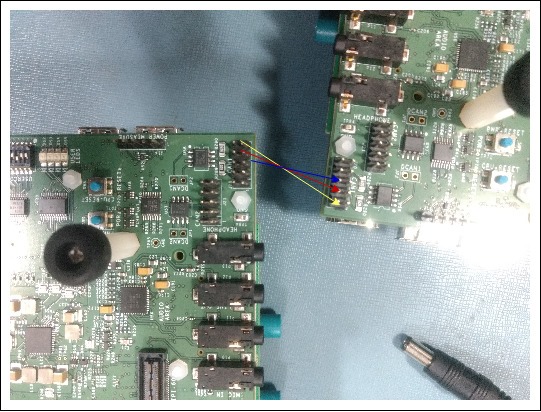

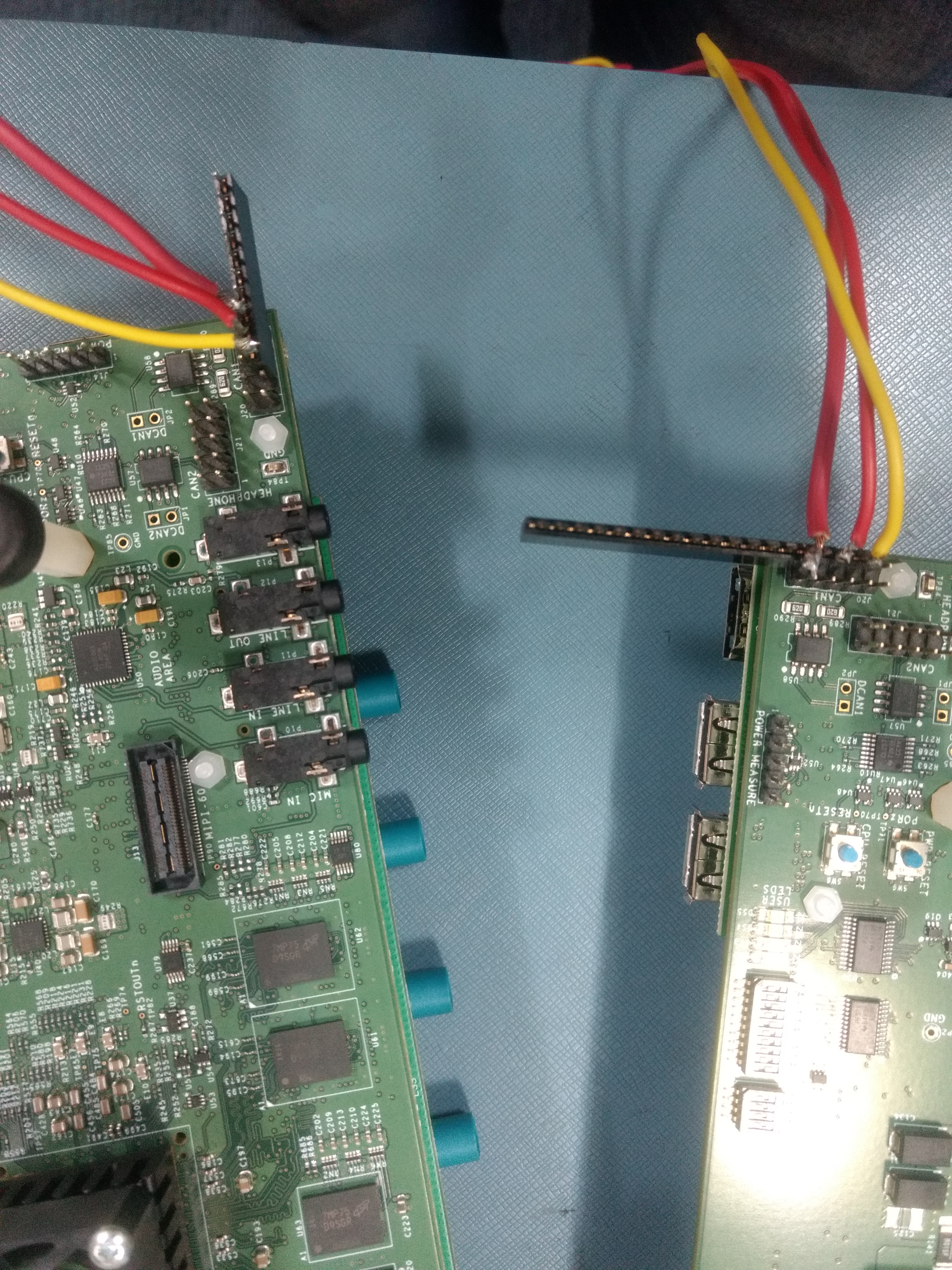

  • Hello Vivek,
    Yes, we have refered the CSL_User_Guide. All the steps mentioned are followed.
    Sharing you the connections diagrams.
    DCAN1(J20 of EVM1) -> DCAN1(J20 of EVM2)
    J20->3 -> J20->3
    J20->4 -> J20->4
    J20->5 to J20->5
    Please let us know if we can have a debug session.

  • Hi Amol,
    From the provided snapshots, looks like you have connected them wrongly.
    You have connections like:
    J20->5 -> J20->5
    J20->7 -> J20->7
    J20->9 to J20->9
    J20 layout is like:
    Please connect by referring above image of J20 connector.
    Thanks & Regards,
    Vivek Dhande.
    Texas Instruments (India) Pvt Ltd
  • Hello Vivek,
    Thanks for your support. We can now test the example successfully.
