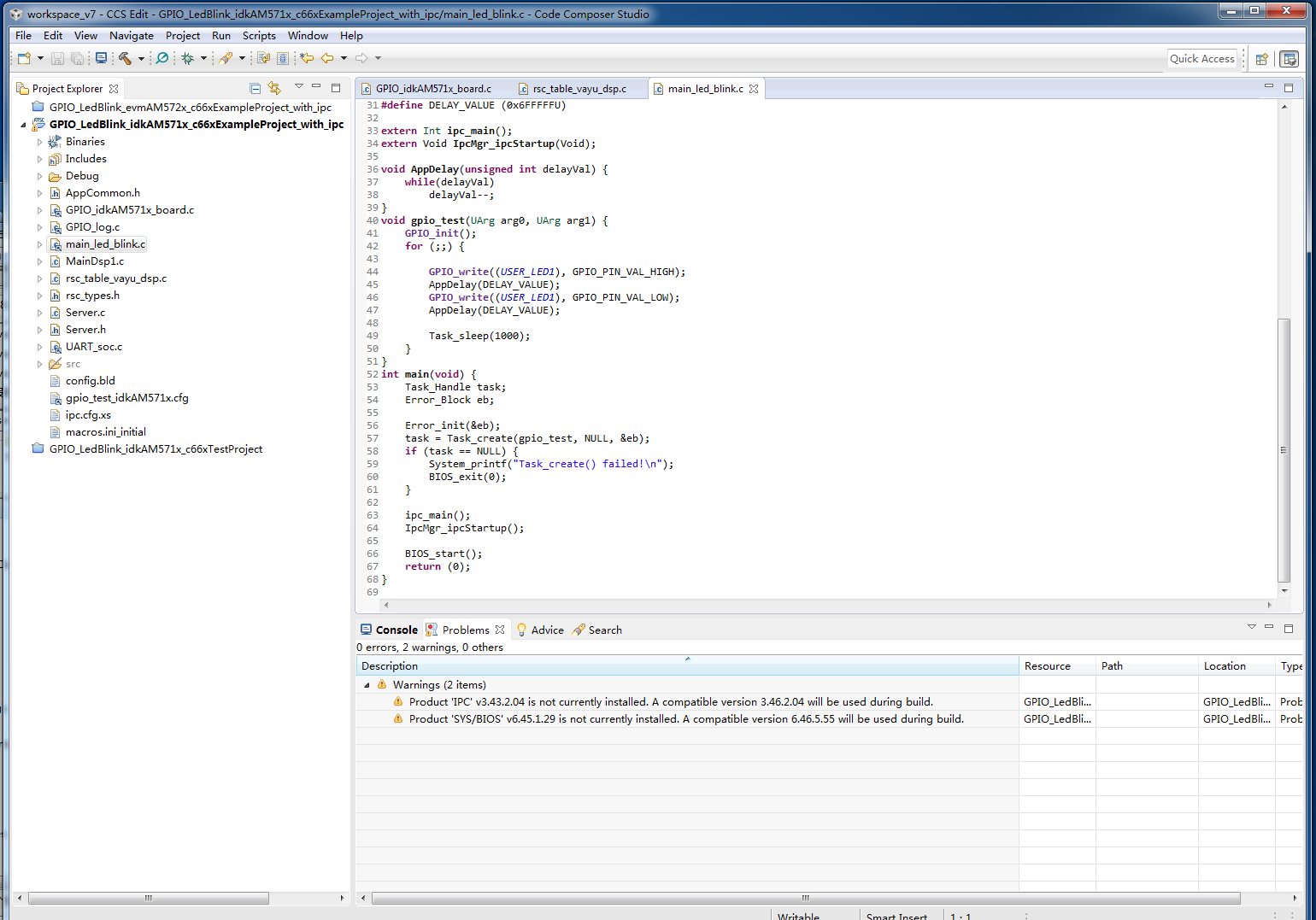

How can i control dsp gpio pin status via ipc? I want to control my led status through the IPC
Hi LJK,
This example blinks the USER0 LED, labeled D4, on the AM572x GP EVM. In order to run this example you'll need to load and run it with the ex02_messageq host example on ARM Linux. Refer to the Processor SDK IPC Quick Start Guide for instructions on how do this.
If you have any questions please let me know.
