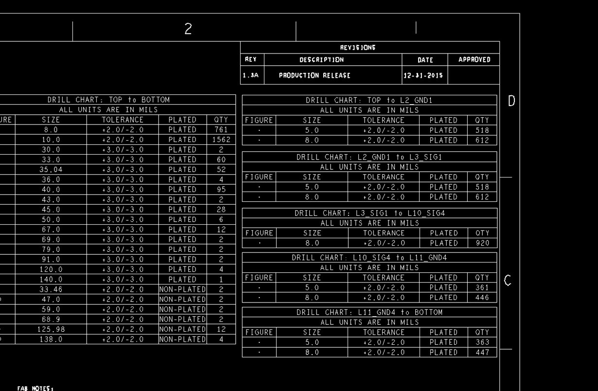

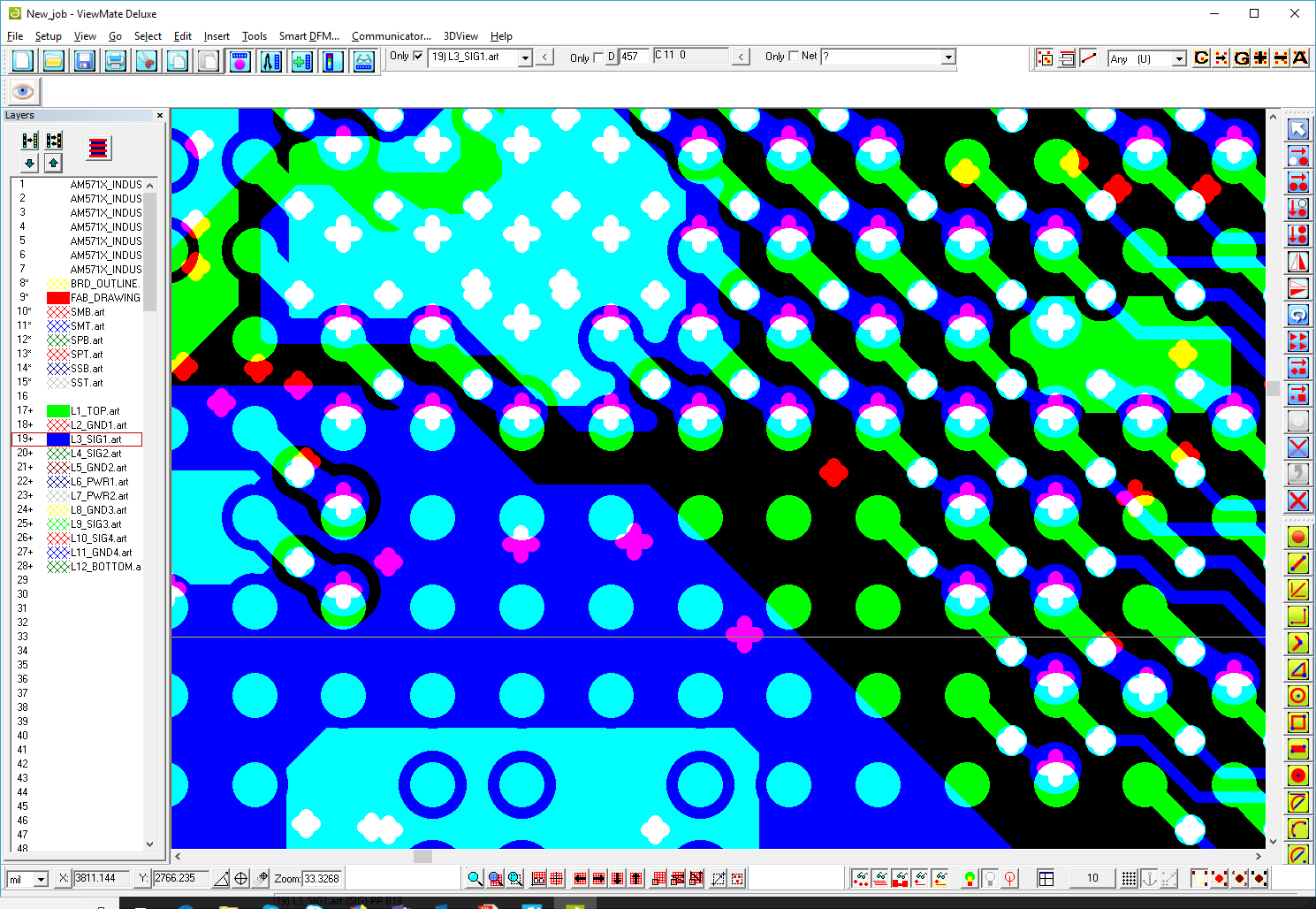

AM5716: IDK PCB layout
Part Number: AM5716
Other Parts Discussed in Thread: AM5718
Customer wants to confirm Does the EVM use blind via holes or Micro Vias? The PCB fab seems to suggest that but wanted to confirm
IDK Gerber Layers don’t seem to be aligned when viewing the drill holes, don’t see this alignment when viewing all the Layers combined (see pics below)
