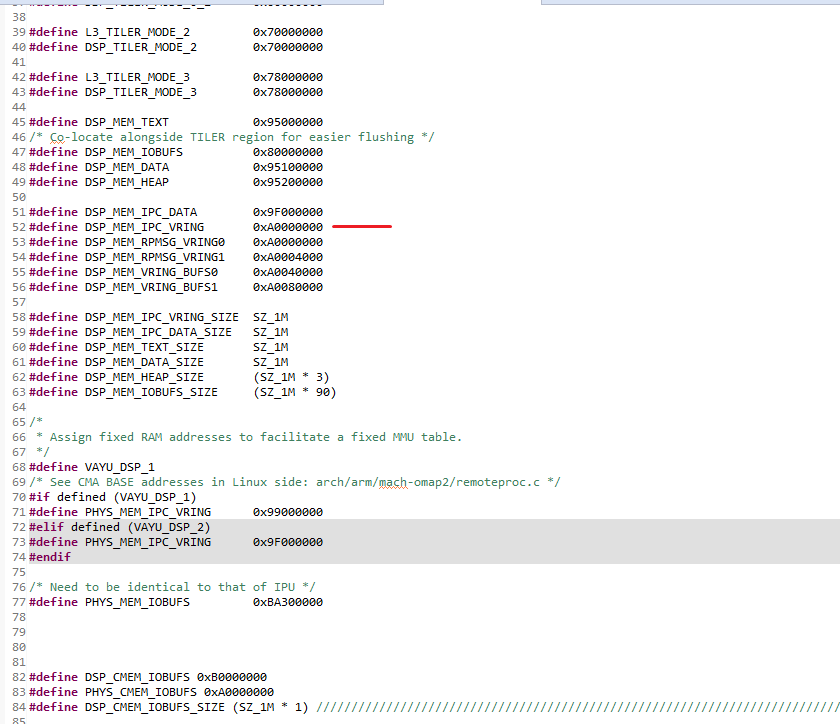

Now I have confirmed the starting address and address range of DDR,But how to get the address of DSP_CMEM_IOBUFS ? please to help me

    DSP_CMEM_IOBUFS corresponds to the address of CMEM block defined in the Linux device tree. These values must match. For AM572x, you can find the device tree file at arch/arm/boot/dts/am57xx-evm-cmem.dtsi.

  • but the DSP_MEM_IPC_VRING was 0xA0000000, and can I set the DSP_CMEM_IOBUFS is 0xB0000000 ? Thanks !
  • LJK,
    You will have to place the CMEM buffers somewhere else since the vring buffers are already at 0xA0000000.
    We have a Big Data IPC example called simple_buffer_example with CMEM already implemented that you may use as reference:

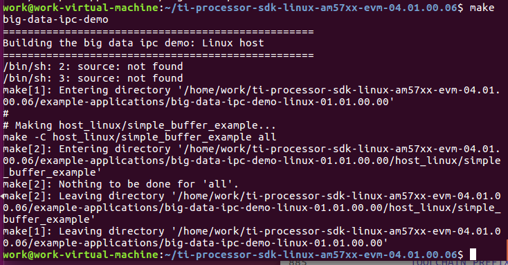

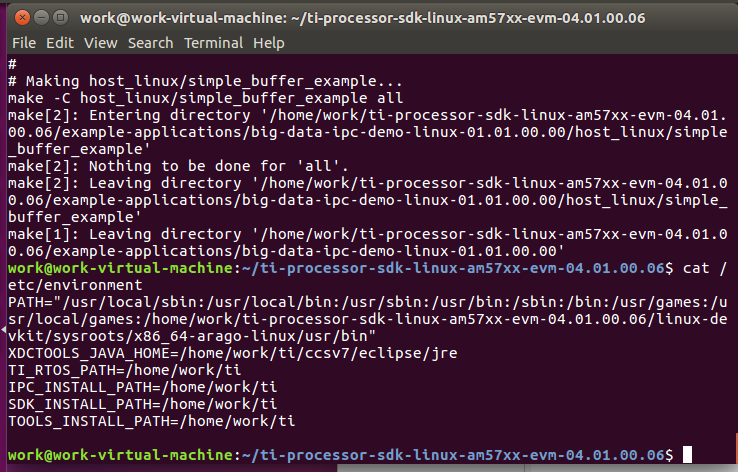

  • when I compiled the big-data-ipc-demo, I was get a warning, please to tell me how to solve this problem ? thanks !
  • LJK,
    By default Ubuntu uses “dash” as the default shell for /bin/sh. You must reconfigure to use bash. How to do this is explained in the Quick Start section of the Processor SDK Linux Developer's Guide.
    Please make sure you have gone through all the steps listed in that guide and try the build again.

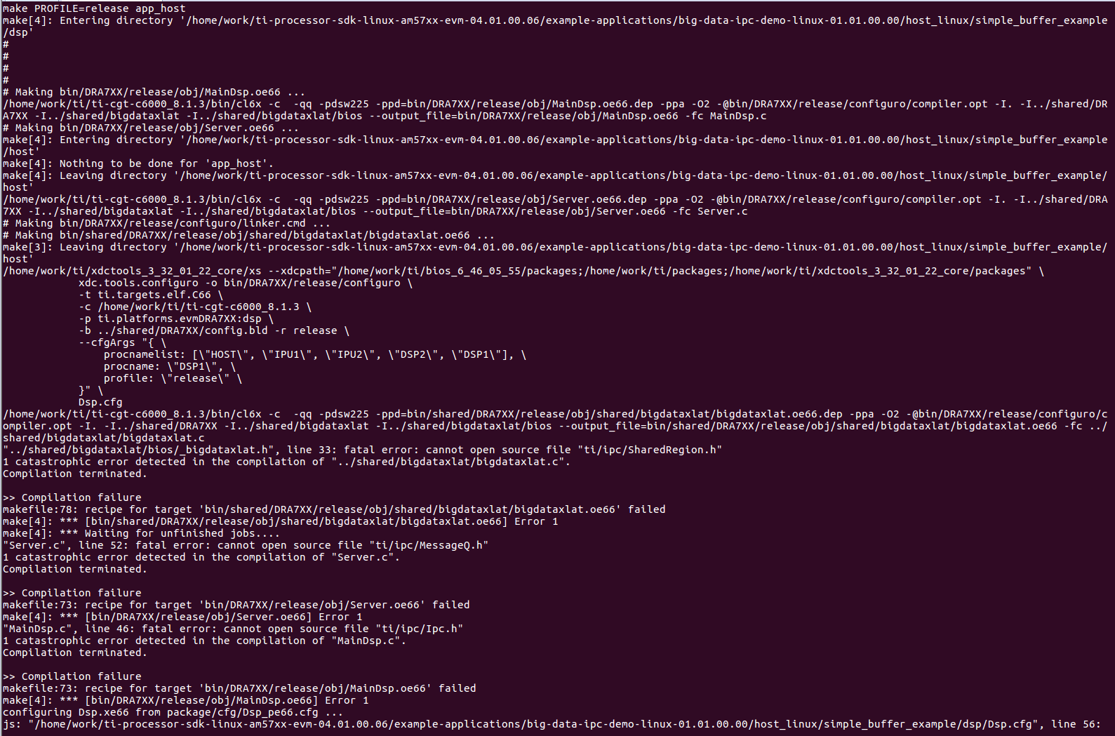

    Thank you for your reply ! But I still have some problems .This is my compiled' log , please to help me ,thank you very much !

  • LJK,
    Processor SDK RTOS is required to build the DSP side binaries. Please make sure you have this installed. The versions need to match so you'll need to download v4.1 of the RTOS SDK as well.
    I was able to build without problems running the following commands.
    $ export TI_RTOS_PATH=/home/sahinlocal/ti/am57xx-4.1/
    (my RTOS SDK is located at /home/sahinlocal/ti/am57xx-4.1/processor_sdk_rtos_am57xx_4_01_00_06)
    $ cd ti-processor-sd-linux-am57xx-evm-04.01.00.06
    $ make big-data-ipc-demo_clean
