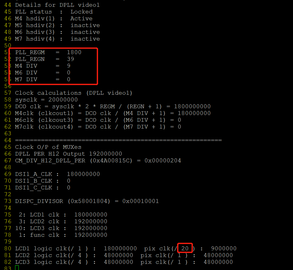

I am working on the splash screen of uboot.The size of my lcd is 4.3 inch,here are the parameter
static const struct lcd_board_data lcd_4_3_inch_data = {
.timings = {
.x_res = 480,
.y_res = 272,
.pixelclock = 9000000,
.hfp = 2,
.hsw = 41,
.hbp = 2,
.vfp = 2,
.vsw = 10,
.vbp = 2,
.vsync_level = OMAPDSS_SIG_ACTIVE_LOW,
.hsync_level = OMAPDSS_SIG_ACTIVE_LOW,
.data_pclk_edge = OMAPDSS_DRIVE_SIG_RISING_EDGE,
.de_level = OMAPDSS_SIG_ACTIVE_HIGH,
.sync_pclk_edge = OMAPDSS_DRIVE_SIG_RISING_EDGE,

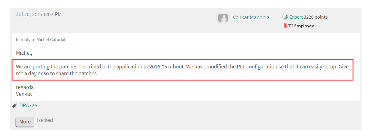

I do not how to configure PLL for my LCD.
According to the description of the links below:Here are some patch for it.
Q1: Where are the patch?
