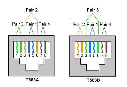

    Is there a problem with the network cable? Must use five types of network cables? The network cable we use is made by ourselves.
    The wiring at both ends is as shown。
    I think you are raising a good question and possibly the answer by looking at the cable type being used in your test. In my test I used about a 1M long cat5e cable which is rated for 1Gbps traffic and I am not seeing any packet loss. With your cable you are experiencing packets loss.
    In the log I provided the Ethernet interface is up at 1Gbps per the line from the log below:
    [ 17.608289] cpsw 4a100000.ethernet eth0: Link is Up - 1Gbps/Full - flow control off
    There are factors for an Ethernet cable such as length limitations, 100M or less. I would recommend trying a different Ethernet cable such as a one that is prefabricated cat5e or cat6 with molded connectors from a different vendor as a means of problem identification. If the issue is the cable this is not something that TI will be able to assist you with solving.
    Schuyler
