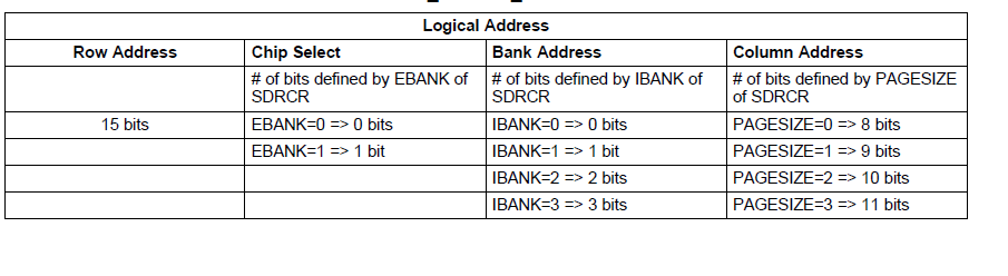

My question is about SDRAM_CONFIG Register Field Descriptions  field descriptions in 《Technical Reference Manual》.
bit 9-7 ROWSIZE  Defines the number of row address bits of connected SDRAM devices. Set to 0 for 9 row bits, set to 1 for 10 row bits, set to 2 for 11 row bits, set to 3 for 12 row bits, set to 4 for 13 row bits,set to 5 for 14 row bits, set to 6 for 15 row bits, and set to 7 for 16 row bits. This field is only used when ibank_pos field in SDRAM Config register is set to 1, 2, or 3,or reg_ebank_pos field in SDRAM Config_2 register is set to 1.
so if ibank_pos in not set to 1,2or3,and reg_ebank_pos also not set to 1,and now what is row_szie's value。
