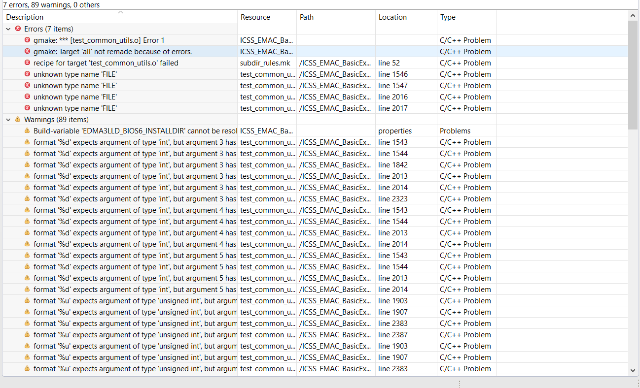

I am new to Sitara processors but I am tryging to learn a bit. According to my previus posts on e2e forum and help I received I prepared examples by clicking "pdkProjectCreate.bat" in ti\pdk_am335x_1_0_10\packages. I tried some of them and they compile and run correct, e.g. in UART or GPIO examples I had "All tests have passed" in PuTTy.
My goal is an Ethernet connection with another device (PC or another TI board) so I tried 'ICSS_EMAC_BasicExample_icev2AM335x_wSoCFile_armTestproject'. It's compiled fine, but in console I haven't got "All tests have passed" info (but I should according to
I loopbacked Ethernet ports and here is my PuTTy log:
ICSS_EMAC_testDrvInit: instance: 1, data0RamSize: 0x2000, data1RamSize: 0x2000, sharedDataRamSize: 0x3000, l3OcmcSize: 0x10000
Validate Firmware: Release1: 0x11, Release2: 0x85010004

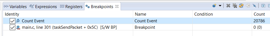

    It works. RetvalTx is 0 and I can see packets in Wireshark on my PC. In Statistics I can see that average speed is 44 Mbits. It's far away from ~ 90 Mbits - on TI wiki sources I found that these Ethernet controllers should work with about 94 Mbits. I checked clock cycles between ICSS_EmacTxPacket calls and it is about 20700:
    With 200 MHz clock, 20786 cycles took 103,93 us. Sending 159 bytes (it is my frame length) takes about 13 us with 100 Mbit speed. Delays in my application are a little bit too big I think. Am I doing someting wrong or I should change something with configuration to decrease them?

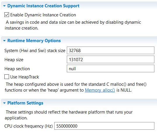

    In BIOS cfg I found that:
    So - Is my AM3359 working with 550 MHz clock? I know that max. clock for AM3359 is 800 MHz but I don't know if I can set it in BIOS cfg 'just like that' and I don't know if Ethernet peripheral has another clock source. I don't know if clock set in platform settings is changed by this line:
    Board_initCfg cfg = BOARD_INIT_PLL| BOARD_INIT_MODULE_CLOCK |  BOARD_INIT_DDR | BOARD_INIT_ICSS_PINMUX | BOARD_INIT_UART_STDIO | BOARD_INIT_ICSS_ETH_PHY;

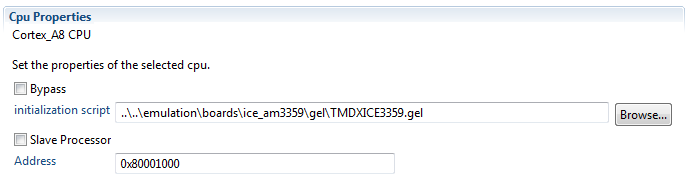

  • Dawid,
    Have you tried to increase the payload size from ETHERNET_FRAME_SIZE_64 to ETHERNET_FRAME_SIZE_1518? The 94Mbps should be measured with a larger payload.
    With default GEL configure - hotmenu ARM_OPP100_Config()
    GEL_TextOut("****  AM335x ALL PLL Config for OPP == OPP100 is in progress ......... \n","Output",1,1,1);
    GetInputClockFrequency();
    if(CLKIN==24)
      MPU_PLL_Config(  CLKIN, 23, 600, 1);
    You can update the CPU clock frequency to 600MHz from the GUI or BIOS.cpuFreq.lo = 600000000; in the cfg file.
    Garrett

    I am not sure if I undestand you correct.  I am just running the device using target configuration and I didn't change the default GEL file:
    Should I change it on: TMDXICE3359_v2_1A.gel? To be honest my board is rev 2.1 but till now nothing caught my attention using examples. This is console output during startup:

    Next - should I change something in GEL file if I want to increase clock or changing clock in BIOS setup is all I have to do?
    BR,
    Dawid.

    I checked throughput with 550 MHz, 600 Mhz and 800 MHz and every configuration looks very similar in timings (just like I wrote, about 144-145k cycles). So I think that delays are generated somewhere and I don't know where exactly.
  • Dawid,
    The GEL script by default configures the ARM core frequency to 600MHz, so accordingly the CPU clock frequency (Hz) should be set to 600000000; in the BIOS cfg. In addition to the OPP100, there are OPP120 and turbo configuration for CPU clock frequency but the VDD_MPU must also be set to 1.2V/1.26V, see ccs_base\emulation\boards\ice_am3359\gel\TMDXICE3359.gel.

    According to clock speed - I found ARM_Turbo_Config() in GEL, but I don't know where I should define VDD_MPU, I can't see it in GEL file. Where should I look for this parameter?
    BR,
    Dawid.
