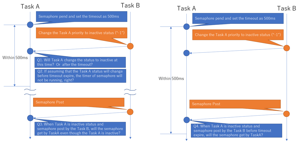

  • Part Number: AM5726
    Tool/software: TI-RTOS
    Hi TI Experts,
    Please let me confirm the following questions.
    [Question]
    Would you please teach me what behavior will the TI-RTOS be with following case?
    If you have any question, please let me know.
    Best regards.
    Kaka
