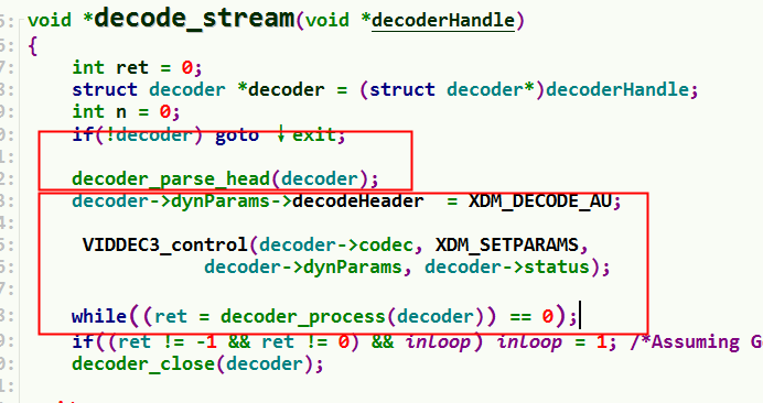

    i read the doc,
    1. Decoder_Create
    2. Control call (XDM_SETPARAMS) to configure decoder in parse
    header mode
    3. Process call to decoder which shall decode SPS+PPS
    4. Control call (XDM_GETBUFINFO) to understand buffer
    requirements
    5. Allocate buffers of size exactly needed to decode this particular bit
    stream
    6. Control call (XDM_SETPARAMS) to configure decoder in normal
    mode (dynamicParams->decodeHeader = XDM_DECODE_AU)
    7. Process calls to decode frames
    but i only know modify the HEAD config :
    decoder->dynParams->decodeHeader = XDM_PARSE_HEADER;
    I don't know what to do next, can you offer the sample code.
    thanks.

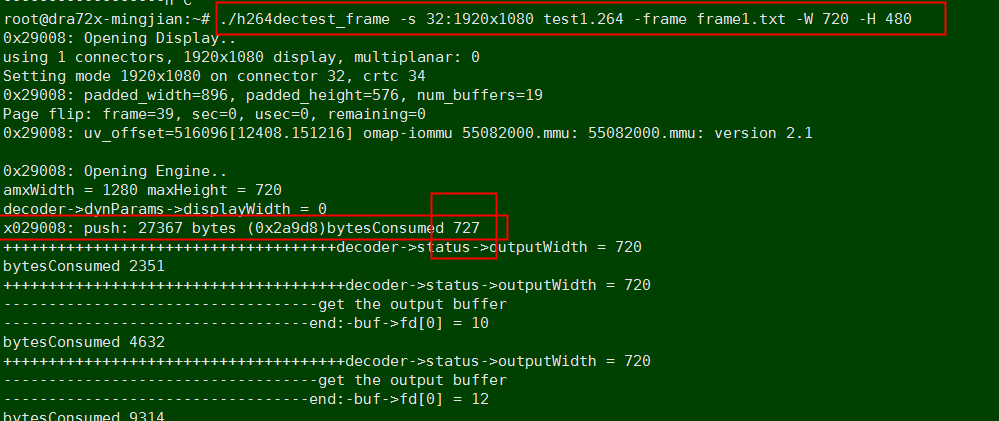

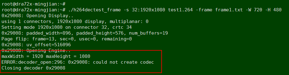

  • Hi Ram,
     modify decoder_open  :
    pdecParams->maxWidth = 1920;
    pdecParams->maxHeight = 1080;
    execut :
    ./h264dectest_frame -s 32:1920x1080 test1.264 -frame frame1.txt -W 720 -H 480
    the error:
    Cesar
  • Hi Cesar,
    I didn't get your requirement. In the application here you are still using -W and -H option to set the width and height.
    Application needs to set maxWidth and maxHeight and create the decoder instance. Then to know the actual width and height, PARSE_HEADER needs to be set.
    Please give more details or share your modified h264dectest
  • Hi Ram,
    the h264dectest_frame.c

    1.decoder_open function:
    pdecParams->maxWidth = 1280;
    pdecParams->maxHeight = 720;
    2. i add the ' decoder_parse_head(decoder) ' function in '  decode_stream'
    execute:parse the 727 byte head, and outputWidth = 720;
    but i don't know read  head, how many bytes;
    Cesar
  • Yes, here 727 bytes is the header size(SPS/PPS). In PARSE_HEADER mode, decoder consumes only header bytes.
    REfer Appendix D Notes of h264decoder userGhide.
