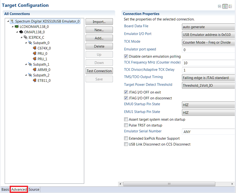

  • I'm still not all the way home with this set up.
    I'm getting errors trying to debug.  In CCS5 there was a window with tabs where I could tweak debugger settings to fix things like this.
    I can't find that window anywhere in CCS7.4
    Where is the window that allows changing settings for the JTAG debugger?  What are the correct settings for a TMS320-XDS100-V3 ?

  • Adam,
    Are you referring to this window?
    You can get here by double clicking on your target config file (.ccxml) and navigating to the advanced tab.
    Make sure you have your boot switches set to UART or EMU mode (all OFF) to ensure code is not already running when trying to connect.
    Also, there was a thread where the same error was reported when using an XDS110 debug probe. Please take a look and see if it helps.
    From this thread,
    "If your XDS does not support adaptive clocking an adapter may be required to achieve the device's full JTAG operating rate. Running the XDS with a TCK rate that is less than 1/8th the ARM's functional clock rate is also an option if adaptive clocking is not supported by your XDS."
    So, try lowering your TCK rate and if that doesn't work then you will need to modify your GEL file to prevent PLLCMD from being set as suggested by Rafael in the thread.
