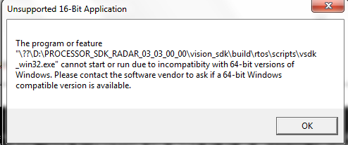

I am trying to use the Usecase generation tool to create the .jpg file in radar SDK. I am using the following command to create these files(usecase_name.priv.c , usecase_name.priv.h, usecase_name.jpg files)
Command is:  vsdk_win32.exe PATH_TO_USECASE_FOLDER/usecase.txt -img -file -path PATH_TO_USECASE_FOLDER/
I was able to create all the files successfully in Vision-SDK, But here I came across with an error saying about the compatibility issue since my system is of 64 bit. (Didnt come across this error while in Vision-SDK )
When I use vsdk_win64.exe trying with the same command, jpeg file is not created and the rest of the files are being created. And when I use executable "vsdk_win32.exe"  present in visionSDK 3.2 and provide the usecase of RADAR-SDK , the jpeg is being created.
Command is:
vsdk_win32.exe PATH_TO_USECASE_FOLDER_IN_RADAR-SDK/usecase.txt -img -file -path PATH_TO_USECASE_FOLDER_IN_RADAR-SDK
In all the cases I have set the PATH to the Graphviz tool. I do not understand what is the issue with the RADAR-SDK's vsdk_win32 .exe

  • Hi Surya,
    Thanks for the informative reply.
    Are these observations made by using vsdk_win32.exe present in Processor VisionSDK version-3.2? I faced no issues when I was using the tool from VisionSDK.
    But when I tried the same thing in RadarSDK version-3.3 I faced issues with the tool present in RadarSDK. And my windows versions is of 64-bit
    These are my experiments:
    Exp 1:vsdk_win32.exe  present in VisionSDK
    UC generation tool: 32 bit
    command: vsdk_win32.exe PATH_TO_USECASE_FOLDER_IN_VisionSDK/usecase.txt -img -file -path PATH_TO_USECASE_FOLDER_VisionSDK
    observation: No issues
    Exp2: vsdk_win32.exe  present in RadarSDK
    command: vsdk_win32.exe PATH_TO_USECASE_FOLDER_IN_RADARSDK/usecase.txt -img -file -path PATH_TO_USECASE_FOLDER_IN_RADARSDK
    observation: compatibility issues
    Exp3: vsdk_win32.exe  present in VisionSDK and usecase in RadarSDK
    observations: works fine. jpg file also created.
    Exp 4: vsdk_win64 in vision SDK
    UC generation tool: 64 bit
    command: vsdk_win64.exe PATH_TO_USECASE_FOLDER_IN_RADARSDK/usecase.txt -img -file -path PATH_TO_USECASE_FOLDER_IN_RADARSDK
    observations: All files are created except .jpg file
    Thanks & regards,
    Varsha
  • Hi Varsha,
    For Exp2,
    Could you please check with the binary file "vsdk_win32" present under "apps\tools\vision_sdk_usecase_gen\bin" folder (Don't use the binary file "vsdk_win32" present under "build\rtos\scripts" folder )
    For Exp4,
    Regarding UC generation tool 64 bit, did you recompile the src on a 64 bit machine & generate the "vsdk_win64" or how is it ?
    Surya
  • Hi Surya,
    For Exp2, I tried with the binary file from the folder you suggested. But still I encounter the same error.
    For Exp4, I did not recompile it. I downloaded it from one of the threads in the e2e forum.
    I also read about the following command to manually create the jpg file:
    Thanks & regards,
    Varsha
  • Hi Varsha,
    Could you please try with attached binary file "vsdk_win64" ?
    vsdk_win64.zip
    Surya
    Yes, This worked!!!
    But, why 32 bit file of RADAR SDK gives an error and not of Vision SDK?
    regards,
    Varsha
