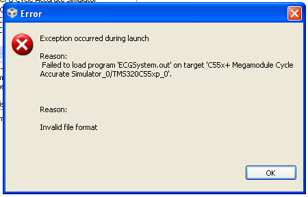

I work with the CCS Programm from your side. But I have a problem with the source Code from the side: http://code.google.com/p/c5505-ezdsp/.
When I debug the Code I get this message.
Can you help me? Can you say me, how I have to set the target configuration?
I look forward to hearing from you.
Heinrich Reimer
  • Hi Heinrich,
    it appears that you tried to download the code to a simulator, not a physical board. Which simulator did you use?
    If you want to use a C55x simultor, please try one of the followings. I have no problem to download the code with the simulators.
    1. C55x Rev 3.0 CPU Cycle Accurate Simulator
    2. C55x Rev 3.0 CPU Functional Simulator
    However, you won't be able to run the code with the simulator. You need a ECG MDK board to be able to run and debug it.
