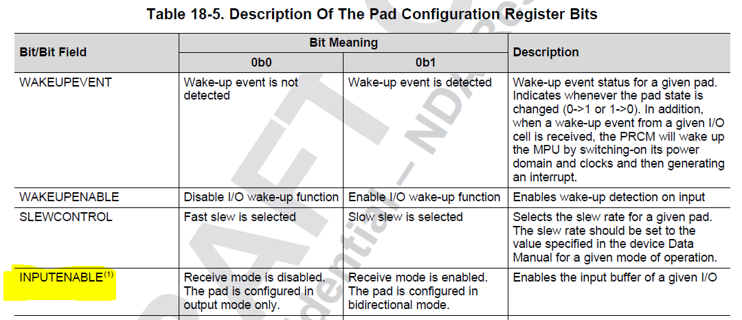

  • Thank you Manisha. Can you check my pinmux of  VOUT3 as my RGB output? I don't know if I should set them as "input", but all the references are as such.
            {GPMC_AD0, (M3 | PIN_INPUT)},   /* gpmc_ad0.vout3_d0 */
            {GPMC_AD1, (M3 | PIN_INPUT)},   /* gpmc_ad1.vout3_d1 */
            {GPMC_AD2, (M3 | PIN_INPUT)},   /* gpmc_ad2.vout3_d2 */
            {GPMC_AD3, (M3 | PIN_INPUT)},   /* gpmc_ad3.vout3_d3 */
            {GPMC_AD4, (M3 | PIN_INPUT)},   /* gpmc_ad4.vout3_d4 */
            {GPMC_AD5, (M3 | PIN_INPUT)},   /* gpmc_ad5.vout3_d5 */
            {GPMC_AD6, (M3 | PIN_INPUT)},   /* gpmc_ad6.vout3_d6 */
            {GPMC_AD7, (M3 | PIN_INPUT)},   /* gpmc_ad7.vout3_d7 */
            {GPMC_AD8, (M3 | PIN_INPUT)},   /* gpmc_ad8.vout3_d8 */
            {GPMC_AD9, (M3 | PIN_INPUT)},   /* gpmc_ad9.vout3_d9 */
            {GPMC_AD10, (M3 | PIN_INPUT)},  /* gpmc_ad10.vout3_d10 */
            {GPMC_AD11, (M3 | PIN_INPUT)},  /* gpmc_ad11.vout3_d11 */
            {GPMC_AD12, (M3 | PIN_INPUT)},  /* gpmc_ad12.vout3_d12 */
            {GPMC_AD13, (M3 | PIN_INPUT)},  /* gpmc_ad13.vout3_d13 */
            {GPMC_AD14, (M3 | PIN_INPUT)},  /* gpmc_ad14.vout3_d14 */
            {GPMC_AD15, (M3 | PIN_INPUT)},  /* gpmc_ad15.vout3_d15 */
            {GPMC_A0, (M3 | PIN_INPUT)},    /* gpmc_a0.vout3_d16 */
            {GPMC_A1, (M3 | PIN_INPUT)},    /* gpmc_a1.vout3_d17 */
            {GPMC_A2, (M3 | PIN_INPUT)},    /* gpmc_a2.vout3_d18 */
            {GPMC_A3, (M3 | PIN_INPUT)},    /* gpmc_a3.vout3_d19 */
            {GPMC_A4, (M3 | PIN_INPUT)},    /* gpmc_a4.vout3_d20 */
            {GPMC_A5, (M3 | PIN_INPUT)},    /* gpmc_a5.vout3_d21 */
            {GPMC_A6, (M3 | PIN_INPUT)},    /* gpmc_a6.vout3_d22 */
            {GPMC_A7, (M3 | PIN_INPUT)},    /* gpmc_a7.vout3_d23 */

  • Please check if pins are toggling. Also, in your pinmux settings, didn't see settings for hsync/vysnc. Are you setting it up?
  • Here are my settings:
    {GPMC_A8, (M3 | PIN_INPUT_PULLDOWN)},   /* gpmc_a8.vout3_hsync */
    {GPMC_A9, (M3 | PIN_INPUT_PULLDOWN)},   /* gpmc_a9.vout3_vsync */
    {GPMC_A10, (M3 | PIN_INPUT_PULLDOWN)},  /* gpmc_a10.vout3_de */
    {GPMC_CS3, (M3 | PIN_INPUT_PULLDOWN)},  /* gpmc_cs3.vout3_clk */
    Let me check toggles on pins. What do you suggest I check first? D0 - D23 on VOUT3?

  • Do you have all the vout3 pins muxed? Looking at another board I see
    {GPMC_CS3, (M3 | PIN_INPUT_PULLUP)}, /* gpmc_cs3.vout3_clk */
    Steve K.
  • {GPMC_A8, (M3 | PIN_INPUT_PULLDOWN)},   /* gpmc_a8.vout3_hsync */
    I got these above. Let me try to set GPMC_CS3 with PULLUP.
  • Tried with GPMC_CS3 with PULLUP. No observable difference (nothing on the screen).
    I suggest to check first the data pins toggling at  VOUT3 and at the output of SN65LVDS. Check LCD is clocked and backlight is working.
    Adam Lee5 said:
    root@am57xx-evm:~# drmdevice drmGetDevices() has returned 0
    It seems  DSS driver is not loaded as DRM cannot find any device. Check this wiki page on driver configuration and loading the module.
    Things can go wrong at any of these steps for you - hardware level, DSS kernel drive build and dts settings, LVDS driver and it's configuration and at the LCD driver side. You need to validate individual step. If everything is good at hardware and software side, then at minimum you should see the LCD lit up (if you are not displaying anything).
  • Thanks, will follow your steps. The backlight is working as expected. Funny enough, the output of "drmdevice" is the exact same on AM5728 IDK (with working LCD).

  • Great. Can you check on the INPUT/OUPUT directions for the pins? Google search shows conflicting results - some show INPUT and others show OUTPUT. Confusing!
  • I figured out and the display is now working. There was nothing wrong on the software front. The LCD panel was faulty.
    If you’re using a pin as an output, then this bit (INPUTENABLE) is a “don’t care.”
    When INPUTENABLE = 0, it’s output only.  When INPUTENABLE = 1, it can operate either as an input or output.
  • Hi Adam,
    Glad that you are able to resolve the issue. For benefit of larger audience, I have replied to your previous query on pinmux settings.
  • I always wondered about this and now it makes a lot of sense. Thank you!
