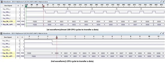

    Hi, one and zero. I moved the PLL initialization to code, the problem still has no change.
    "Abnormally" in my problem is that EDMA3 works abnormally. It transfers a data using dozens of CPU cycles when the program first loaded, but after reload or restart the program, it can transfer a data in a CPU cycle.

    RandyP said:
    Can you observe the data being transferred to the FPGA RAM using a logic analyzer or oscilloscope? It could be valuable to see how the data transfer progresses differently between the slow and fast cases. Just looking at the WEn signal should be sufficient if you use a scope.
    I sample the EIMF signals in chipscope(xilinx's logic analyzer), the waveform is showed below:
  • If you are doing a CPU reset before each run, there is no DSP-based reason for the executions to be different. What are the conditions that result in getting the "first time" higher timer value? Is this when you apply power to the board, or bring up CCS the first time, or apply reset to the board including the FPGA? In other words, what can you do that will guarantee you get the slower numbers every time?
    The TIMLO numbers only differ by 2x, not 100x. Even though I cannot tell what the signals are in your waveform (too blurry to read), I can guess that the second line in the first picture is WEn. But I cannot tell what the clock ticks mean. The caption implies CPU cycles, but does the FPGA even receive the CPU clock, or does it receive the EMIF clock? What is the clock tick measured in the waveform?
    How do you have the EMIF configured? Asynchronous mode or synchronous mode? Wait states, external RDY signal from FPGA?
    Since the TIMLO numbers differ by 2x but your waveform says 100x, there is something else being measured in your benchmark timing. Please insert the following to take an additional timer reading when the DMA channel completes. Please this immediately after the write to EDMA3_ESRH.
    while ( (EDMA3_IPRH & 0x00008000) == 0 );
    Timer_GetCurrentCount(TIMER0, & TimerCount1);
    What do you think is causing the differences?
    The reason why the TIMLO numbers are different is that 2x is tested from the program start to finish, and 100x is only tested from EDMA3_ESRH = 0x00008000; to EDMA3_ICRH = 0x00008000; .
    About the waveform, FPGA only receives the EMIF clock, and it uses EMIF clock to sample the signals of EMIF. The wavefom is just the EMIF interface signals, From it ,we can see in the below figure, EDMA transfers a data in a clock cycle, but in the above figure, it uses dozens of cycles.
    This helps to explain one point. Since EMIF clock is not the same as CPU clock, the labels and comments about transfers in CPU clocks should state that the transfers are in EMIF clocks. This helps me understand this distinction.
    GANG ZHANG said:
    It configured synchronous mode. read_latency = 2
    The waveforms you posted are blurry, so I cannot tell exactly what is going on. But my best guess is that the top waveform shows the EMIF running in Asynchronous mode and the bottom waveform shows the EMIF running in Synchronous mode. Perhaps this is your problem, the configuration of the EMIF.
