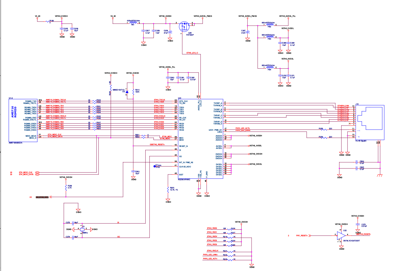

Dear Team,
We have a custom boards based on AM5716 CPU. We are using RGMII0 only Gigabit Ethernet in our design. I am running ti-processor-sdk-linux-am57xx-evm-03.03.00.04, with Buildroot file-system. Part of the schematic is attached.
eth0 links is not getting ready.
# ethtool eth0
Settings for eth0:
    Supported ports: [ TP MII ]
    Supported link modes:   10baseT/Half 10baseT/Full
                            100baseT/Half 100baseT/Full
                            1000baseT/Half 1000baseT/Full
    Supported pause frame use: Symmetric
    Supports auto-negotiation: Yes
    Advertised link modes:  10baseT/Half 10baseT/Full
    Advertised pause frame use: Symmetric
    Advertised auto-negotiation: Yes
    Speed: 10Mb/s
    Duplex: Half
    Port: MII
    PHYAD: 0
    Transceiver: external
    Auto-negotiation: on
    Supports Wake-on: d
    Wake-on: d
    Current message level: 0x00000000 (0)
    Link detected: no

1) I have changed the slave to 1 for mac and I do not need PRU-ICSS is my understanding, please  help me what could be the reason ?
    There is not a link being detected by the PHY. This is a function between the link partners, since auto negotiation is enabled there is something perhaps going wrong at this stage. The PHY datasheet or perhaps their forums can provide some debug tips to indentify why a link is not being established.  Until a link is detected the ethernet driver will not completely initialize.
    The boot log shows the PHY is being indentified so this indicates that the MDIO communications with the PHY is working.
    Schuyler
  • Part Number: AM5718
    Tool/software: Linux
    Hi TI
    A custom board with reference to AM5718, How to cross check the RGMII interface status is fine. between MAC to PHY. This is because i am not able to find link detection succes in Ethernet with ethtool.
    So before jump to debug PHY side i want to confirm, till mac every thing is fine.
    I am using same .dts config data for ethernet which used in am571x-idk.dtsi, to my custom board. but my custom board has only one interface port.
    Can you pleas help me, where i am wrong, what else need to check.
    Anil
    I think the PHY side will need to be looked at first. Until a link is detected the MAC setup will not matter as no data could pass on the line. The boot log that was attached is showing that PHY 0 is being identified correctly and is attached to eth0. So the MDIO portion of the interface is operational.
    The cpsw driver will check the PHY link status and will not continue with init if the link is not detected.
    One suggestion for checking the RGMII interface with the PHY is that you may be able to develop some code that puts the PHY in loopback mode. Please check with your PHY manufacturer as they may have example code that performs this loopback test. TI does not have examples or support this particular loopback test.
    Schuyler
  • Hi Schuyler,
    We have debugged this problem and found PHY is causing the issue as link could not be established.
    KSZ9031RNXC 48-pin ISET should have a 12.1K resister connected to GND, during the PCB assembly 12ohm resistor is placed instead of 12.1K, because of this PHY misbehaved. After replacing resistor with right value link is established and eth0 is up.
    Thanks for your inputs.
