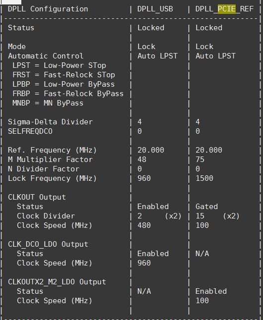

    omapconf show dpll, as follow.Please help see where there is a problem.Thanks.
  • Hi, ,
    As I see from your picture, the PCIE DPLL is configured properly. Its output clock is 100MHz. This output clock is supplied to the APLL to generate the required 2.5 or 1.25 GHz clock.
    Pay attention that you should set a proper values in the following bits CM_CLKMODE_APLL_PCIE.REFSEL and CM_CLKMODE_APLL_PCIE.CLKDIV_BYPASS. The first one selects the reference clock for the APLL. The second one selects the output divider, i.e. whether the output APLL clock shall be 2.5Ghx or 1.25Ghz. For more information about these bits, please refer to 3.11.15 CM_CORE__CKGEN Registers section in the same document Shravant had given a link above.
    Mariya
