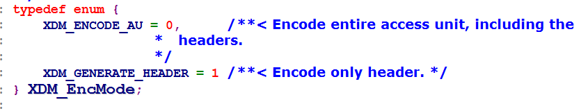

   encoded the h.264, the configue:
I look at the ‘XDM_ENCODE_AU’ configuration instructions:include head
but the h.264 file without head info--PPS,SPS:
or can you offer encode only header code operating steps.
Cesar
  • Hi Cesar,
    Did you modify any paramters in videnc2test?
    I tried this command and generated output h264 bitstream has both SPS and PPS
    videnc2test 352 288 40 /usr/share/ti/video/airshow_p352x288.yuv out.h264 30 512 h264 baseline 41 OMAPDRM
  • Hi Ram,
    I haven't modified it, i test your example.
    the videnc2test.c

        dynParams->generateHeader = XDM_ENCODE_AU;

  • HI Cesar,
    Output is proper. Are you expecting a stream without SPS/PPS header?
  • Hi Ram,
    now i think only encode head, how to operate.
    Cesar
  • Hi Cesar,
    Please search for GENERATE_HEADER in H264Encoder userGuide for more information on how to use XDM_GENERATE_HEADER. A control call should be followed by a VIDENC2_process call to insert header in certain frames.
    I applied this patch to insert header after every 10th frame. Please check this.
    diff --git a/videnc2test.c b/videnc2test.c
    index 9a3c334..6171084 100644
    --- a/videnc2test.c
    +++ b/videnc2test.c
    @@ -1302,6 +1302,19 @@ int main(int argc, char * *argv)
     				h264enc_outArgs = (IH264ENC_OutArgs *) encObj.outArgs;
                     MSG("TEST inArgs->inputID %d h264enc_inArgs->videnc2InArgs.inputID %d",
     						 encObj.inArgs->inputID, h264enc_inArgs->videnc2InArgs.inputID);
    +		/* Set HEAEDER Generation for every 10th frame */
    +		if(in_cnt && (in_cnt % 10 == 0)){
    +		   IH264ENC_DynamicParams* h264enc_dynParams = (IH264ENC_DynamicParams *) encObj.dynParams;
    +		   h264enc_dynParams->videnc2DynamicParams.generateHeader = XDM_GENERATE_HEADER;
    +		   err = VIDENC2_control(encObj.codec, XDM_SETPARAMS, (VIDENC2_DynamicParams *) h264enc_dynParams, (VIDENC2_Status *) (encObj.h264enc_status));
    +		   if( err ) {
    +			ERROR("Codec_control returned err=%d, extendedError=%08x", err, encObj.h264enc_status->videnc2Status.extendedError);
    +		   h264enc_dynParams->videnc2DynamicParams.generateHeader = XDM_ENCODE_AU;
                     err = VIDENC2_process(encObj.codec, encObj.inBufs, encObj.outBufs, (VIDENC2_InArgs *) h264enc_inArgs, (VIDENC2_OutArgs *) h264enc_outArgs);
                     MSG("[DCE_ENC_TEST] VIDENC2_process - err %d", err);
    Ram
