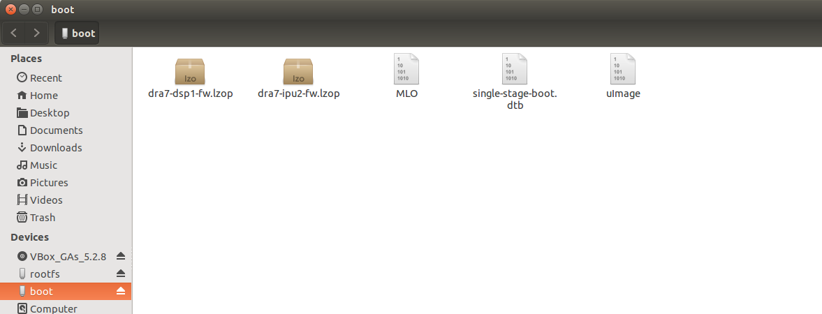

    Please ensure the contents of the boot partition of the your SD-card are only the below files (any other file except the below files else needs to be deleted):
    1. MLO
    2. single-stage-boot.dtb (this is dra72-evm-infoadas.dtb file, but is renamed)
    3. uImage
    4. dra7-ipu2-fw.xem4
    5. dra7-dsp1-fw.xe66
    You should notice the kernel boot up with these changes.
    Also, please ensure the board is set to production-SD boot mode by configuring the SYSBOOT settings below:
    SYSBOOT [0-15] 00001100 10000001
    Shravan

    so dsp and ipu filename extension  should be .lzop ?
    my sd card boot partial is like below,
    but MLO still not read iImage ....

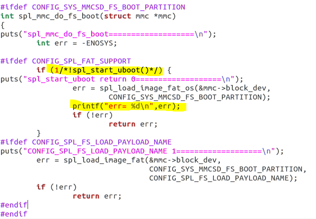

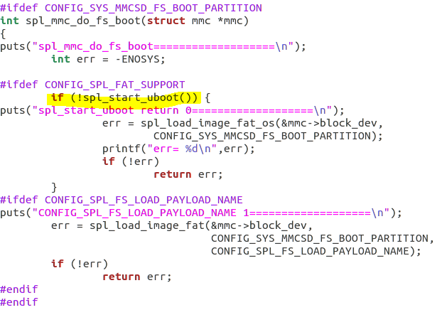

    In addition, I have seen the configuration of single stage or falcon,
    Just like this link,
    https://e2e.ti.com/support/arm/automotive_processors/f/1021/p/618773/2280079
    is that Earlyboot  supposed to do the same setting with my visionSDK version and board ?

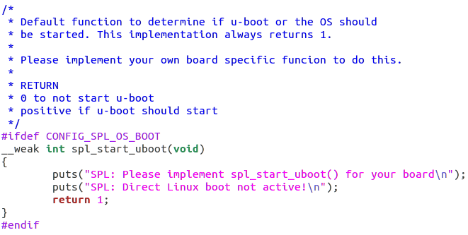

    There seems to be an issue with your u-boot environment.
    Please follow the below steps:
    1. From the u-boot repository, copy u-boot.img to the boot partition. So now your boot partition should have the following contents:
    a) MLO
    b) u-boot.img
    c) dra7-ipu2-fw.xem4
    d) dra7-dsp1-fw.xe66
    e) single-stage-boot.dtb
    f) uImage
    3. Reboot the board, you should now see it load u-boot. Halt at u-boot, and run the below command
    env default -fa
    saveenv
    4. Once this is completed, eject the card and remove u-boot.img from the boot partition, and then reboot the board, it should boot kernel.
    Shravan
    i followed your steps,
    the spl still not reads uImage.

    I am indeed in SD mode,
    i traced the spl code,
    debug and output some log to confirm the spl flow,
    finally, i found in spl_mmc.c
    spl_start_uboot() will return 1,
    so i always not going to spl_load_image_fat.
    This is the cause of unread single-stage-boot.dtb and uImage.
    I found spl_start_uboot() is defined in spl.c like below,
    it do nothing and always return 1,
    so i change  this "If" predicate,
    finally, my board can excute to root,
