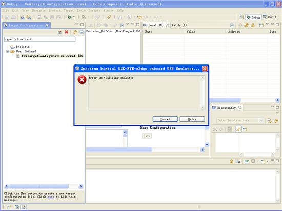

  • TommyG,
     Thanks for your kind help,when i install ccsv4,the 560 pci is installed with i installed the ccs,but the 5515EVM can not connect with the CCS,here is the error message:
    Could you tell me how can i sove this problem?Thank you!
    Regards.
  • Wang,
    When I've seen this message it usually means that I either don't have the Target Configuration setup correctly, or that I haven't associated a Target Configuration with the project I am trying to debug.  I would check these items first.  Details are in the Getting Started link I pointed you towards in my previous response.
    The XDS560 error in the Device Manager is not related to the problem you are seeing.  It means that you don't have an XDS560 emulator installed in your system.  For some reason CCS install loads the driver, even if you aren't going to use that particular emulator.
    Regards.
