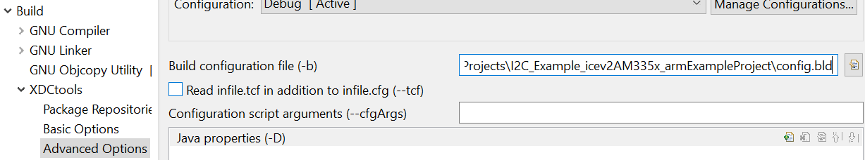

    Then, go to Project Properties->CCS Build->XDCtools->Advanced Options, and type ${PROJECT_ROOT}/config.bld in the text field for Build configuration file.
    When you rebuild your project, you should see your code in SRAM_HI.

    To customize the code/data placement, I created a config.bld file with one line: Build.platformTable["ti.platforms.evmAM3359"] = {dataMemory: "SRAM_HI"};
     Then add into my CCS project:
    and build, I can see now in the auto-generated linker.cmd:

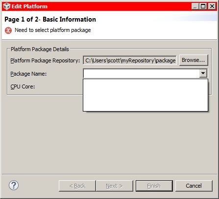

  • Eric,
    First of all, the dialog you showed me is empty...
    Second, I did use the "bld" file, and it also overflows, just as your does.  There is no setting I can find to reduce the heap or stack size.  Every place I found it (and there were several) had no effect. Am I the only person who finds it ridiculous that these setting are in multiple places...  and even worse, they doesn't seem to have any effect??  (I set it in every place I can find to 0x100 for both STACK and HEAP.  It claims it overflows by 16MEG!! )

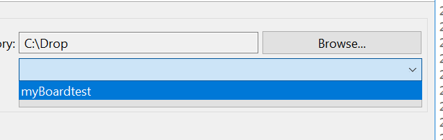

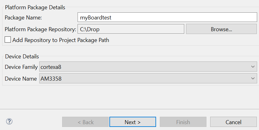

  • Scott,
    For issue 1,  I tried to create a platform myself by:
    1. platform---->new, then type in the package name, location, device family, device name
    Then, import what evmAM3359 had for simplicity (or your can fill in yourself)
    I have no issue to save it and open later:

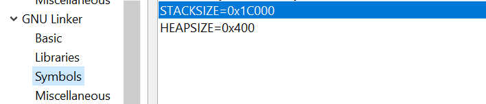

    For issue 2, the heap and stack size are defined:
    For issue 3, I asked my RTOS team colleague to comment.
    Regards, Eric
  • Eric,
    For issue 2, that is exactly what I am changing, and it is having no effect. I am also changing the entries in the CFG file, and that is also having no effect. Please pass that onto the RTOS team as well.
    If you change the heap/stack size but didn't get what you expected, can you double check the build log, in the linking stage, you can typically see:
    'Invoking: GNU Linker'
    "C:/ti/ccs_7_4_0/ccsv7/tools/compiler/gcc-arm-none-eabi-6-2017-q1-update/bin/arm-none-eabi-gcc.exe" -mtune=cortex-a8 -marm -Dam3359 -DSOC_AM335X -Dicev2AM335x -g -gdwarf-3 -gstrict-dwarf -Wall -mfloat-abi=hard -Wl,-Map,"I2C_Example_icev2AM335x_armExampleProject.map" -nostartfiles -static -Wl,--gc-sections -L"C:/ti/bios_6_52_00_12/packages/gnu/targets/arm/libs/install-native/arm-none-eabi/lib/hard" -Wl,--defsym,STACKSIZE=0x1C000 -Wl,--defsym,HEAPSIZE=0x400 --specs=nano.specs -o"I2C_Example_icev2AM335x_armExampleProject.out" "./I2C_log.o" "./UART_soc.o" "./main_eeprom_read.o" -Wl,-T"configPkg/linker.cmd" -Wl,--start-group -lrdimon -lgcc -lm -lnosys -lc -Wl,--end-group
    If I changed above inside my CCS project, I saw that reflected in my build log.
