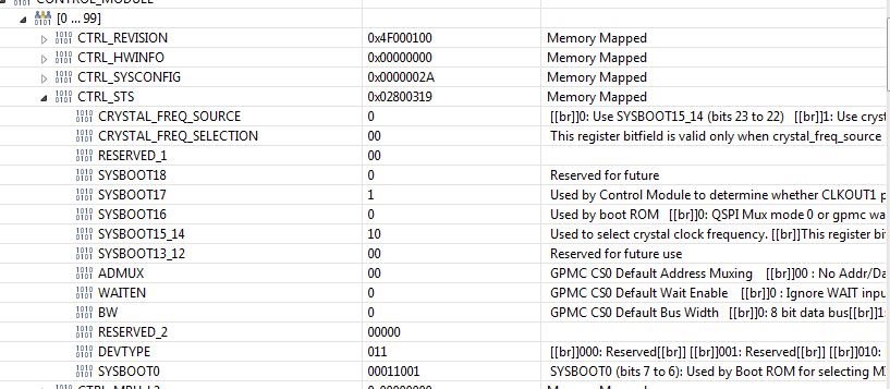

In a Custom board based on AM437x we have mounted MT29F4G08ABADAWP NAND flash and we are able to read write to NAND. But Booting from NAND is not working after POR. Followings are the boot priorities: UART0 -> NAND_I2C -> NAND -> MMC0. The sysyboot pins are: [4:0] = 11001b, [6] -> LOW [8] -> LOW [11] -> LOw [15:14] -> 10b (Using 25Mhz System Clock).

    attached the trace dump. Please help us analyze the trace dump.
  • Can you also post registers r0 - r15?
    Steve K.
  • PC	0x00034E28	Program Counter [Core]
    SP	0x40338D2C	General Purpose Register 13 [Core]
    LR	0x4033B860	General Purpose Register 14 [Core]
    CPSR	0x800001F3	Stores the status of interrupt enables and critical processor status signals [Core]
    R0	0x40338ED8	General Purpose Register 0 [Core]

    Please find the register trace

    And register dumps:
  • I can explain the error message you are seeing from MLO. After the boot ROM loads MLO into internal RAM and executes it, register r0 is loaded with the address of a boot parameter structure. One field is a device ID of what you booted from. MLO then goes to look for u-boot.img on that media. If r0 is not pointing to a valid structure, the device ID field will be incorrect and you see that error message.
    Steve K.
