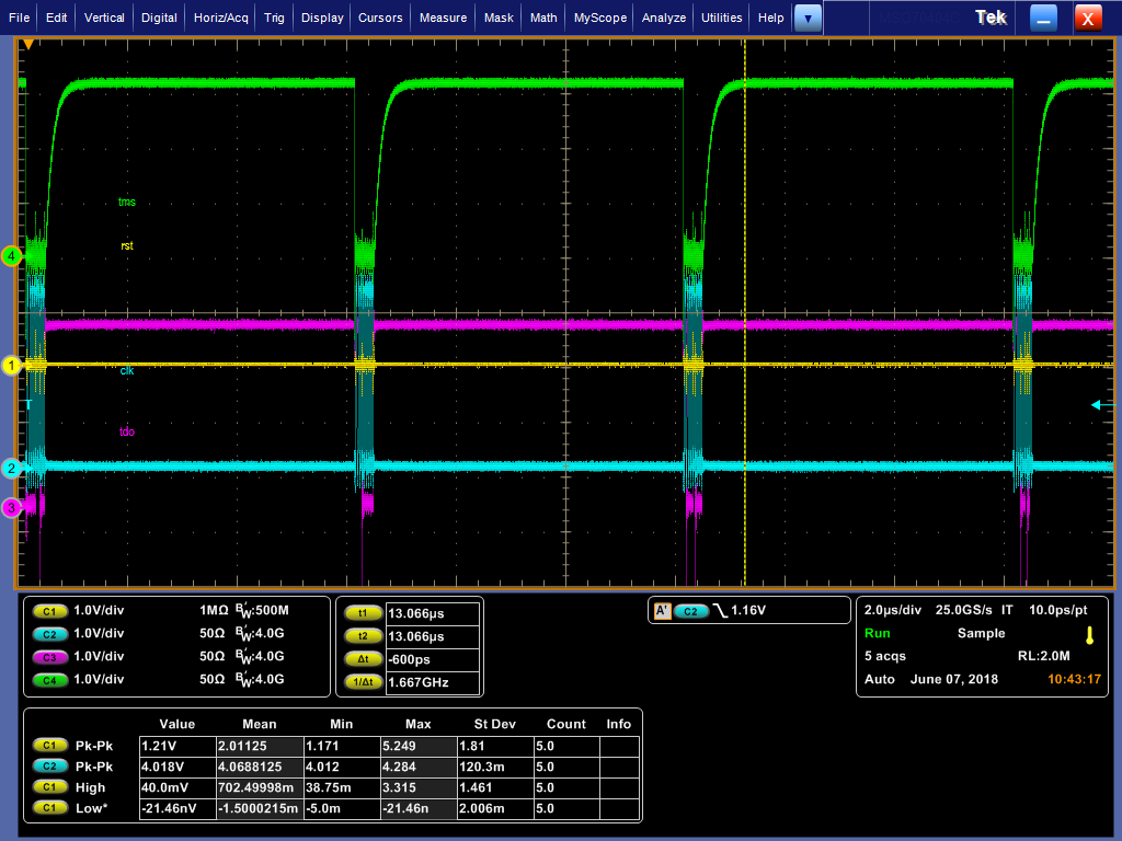

  • Hi Rahul,
    thanks for your quick reply. Yes I'm using the TMDXICE110 and using there the SPI winbond Flash to boot the system.
    The Image is around 3MByte and takes 20 seconds to boot. I just measured it again.
    To get an idea, what I'm talking about, here some pictures.

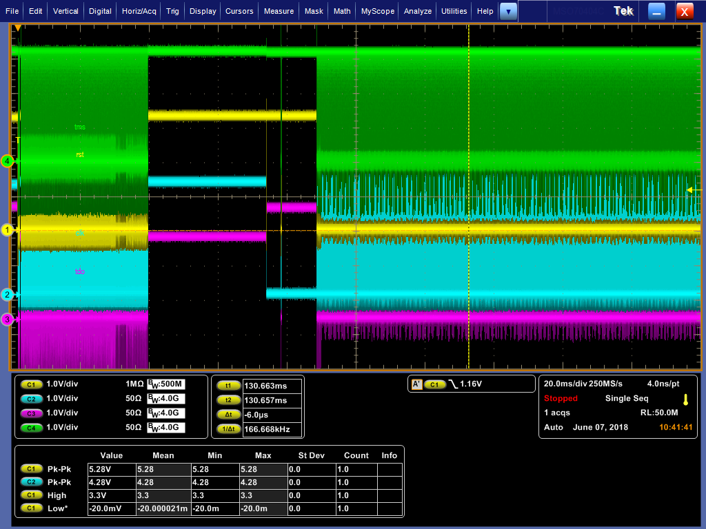

    This is almost the hole booting process at the spi bus. The names of the signals are wrong, see the pictures lower for the write labeling.
    So it looks like the boot process is separated into two processes. The second one takes much longer than the first one. So I think the main Image is transferred during the second process.

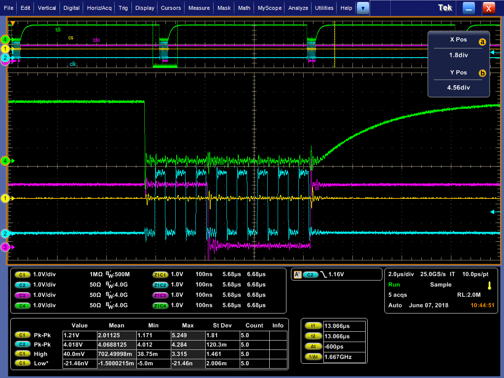

    To see whats going on, during reading the Flash, I took two other pictures, which are zoomed into the second process:
    So what you see here, is that the data is transferred with 25MHz, as wanted. But between two bytes the amic waits 6µs for nothing... Why it is doing that?
    If it just would wait for 1µs it would speed up the process from 20s to approximately 3s. This would be ok for me. 1s would be even better.
    I had a look into the write_flash program and I couldn't see any wait command. Maybe you have an idea?
    In my opinion it is not the fault from the flash, but an problem of the amic boot process.
    Stefan
