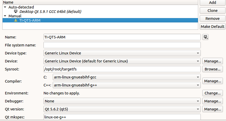

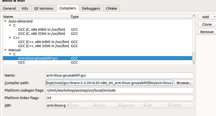

    2. In QtCreator, I set the sysroot and cross-compiler to vision SDK, but it still use the linux-devkit.
    • QTCreator UI
    • and the compiler output is:
    arm-linux-gnueabihf-gcc -c -pipe  -march=armv7-a -marm -mfpu=neon  -mfloat-abi=hard --sysroot=/opt/ti-processor-sdk-linux-automotive-dra7xx-evm-03_04_00_03/linux-devkit/sysroots/armv7ahf-neon-linux-gnueabi -g -Wall -W -D_REENTRANT -fPIC -DAPP_RUN_ON_PC -DQT_QML_DEBUG -DQT_WIDGETS_LIB -DQT_GUI_LIB -DQT_CORE_LIB -I../avm_qt_app -I. -I/opt/ti-processor-sdk-linux-automotive-dra7xx-evm-03_04_00_03/linux-devkit/sysroots/armv7ahf-neon-linux-gnueabi/usr/include/qt5 -I/opt/ti-processor-sdk-linux-automotive-dra7xx-evm-03_04_00_03/linux-devkit/sysroots/armv7ahf-neon-linux-gnueabi/usr/include/qt5/QtWidgets -I/opt/ti-processor-sdk-linux-automotive-dra7xx-evm-03_04_00_03/linux-devkit/sysroots/armv7ahf-neon-linux-gnueabi/usr/include/qt5/QtGui -I/opt/ti-processor-sdk-linux-automotive-dra7xx-evm-03_04_00_03/linux-devkit/sysroots/armv7ahf-neon-linux-gnueabi/usr/include/qt5/QtCore -I. -I/opt/ti-processor-sdk-linux-automotive-dra7xx-evm-03_04_00_03/linux-devkit/sysroots/x86_64-arago-linux/mkspecs/linux-oe-g++ -o video_sync.o ../avm_qt_app/video_sync.c
    > As you know, we'are working based on vision SDK not the PSDKLA, how much difference between them?
    If your intention is to develop on Qt then you have only one option that is to use the PSDKLA 3.04. So there is no need to compare the two.
    Vision SDK and PSDKLA are catering to different products and market segments, please refer to the respective User Guides to understand the differences. The answer to this question is beyond the scope of this post.
    If there are any other follow up questions, please do reply back. For now, I think you are enabled and I'm marking this as closed.
