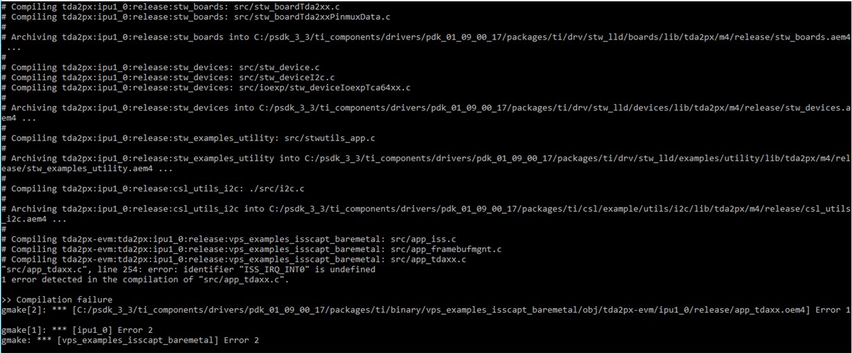

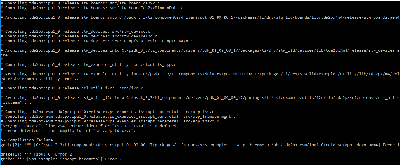

  • Hi Sujith,
    I am working with Swati on this.
    I tried to build "vps_examples_isscapt_baremetal" from "psdk_3_3\ti_components\drivers\pdk_01_09_00_17\packages\ti\build".
    I made following changes in "vps_component.mk" at "psdk_3_3\ti_components\drivers\pdk_01_09_00_17\packages\ti\drv\vps\",
    -  vps_examples_isscapt_baremetal_BOARDLIST = tda3xx-evm
    + vps_examples_isscapt_baremetal_BOARDLIST = tda2px-evm
    -  vps_examples_isscapt_baremetal_tda3xx_CORELIST = ipu1_0
    + vps_examples_isscapt_baremetal_tda2px_CORELIST = ipu1_0
    Also in the makefile of "C:\psdk_3_3\ti_components\drivers\pdk_01_09_00_17\packages\ti\drv\vps\examples\iss\isscapt_baremetal_app\makefile", I have replaced "tda3xx" with "tda2px".
    After doing above changes I tried to build the example with following command,
            gmake -s vps_examples_isscapt_baremetal CORE=ipu1_0 BOARD=tda2px-evm
    but I am getting following error,
    This IRQ "ISS_IRQ_INT0" belongs to tda3xx and we searched in the TRM and we found that for tda2px, "ISS_IRQ0" needs to be added.
    But this IRQ is not added in "C:\psdk_3_3\ti_components\drivers\pdk_01_09_00_17\packages\ti\drv\stw_lld\platform\src\tda2xx\irq_xbar_interrupt_ids.h" file.
    Can you suggest how can we fix this.
    Abhay
  • Hi Abhay,
    Please try the VPS example, \ti_components\drivers\pdk\packages\ti\drv\vps\examples\iss\captureIss\src\CaptureIss_main.c
    and choose option "Sensor Config Bypassed CSI2 4Lanes capture color bars from UB954"from the uart console.
    Sujith

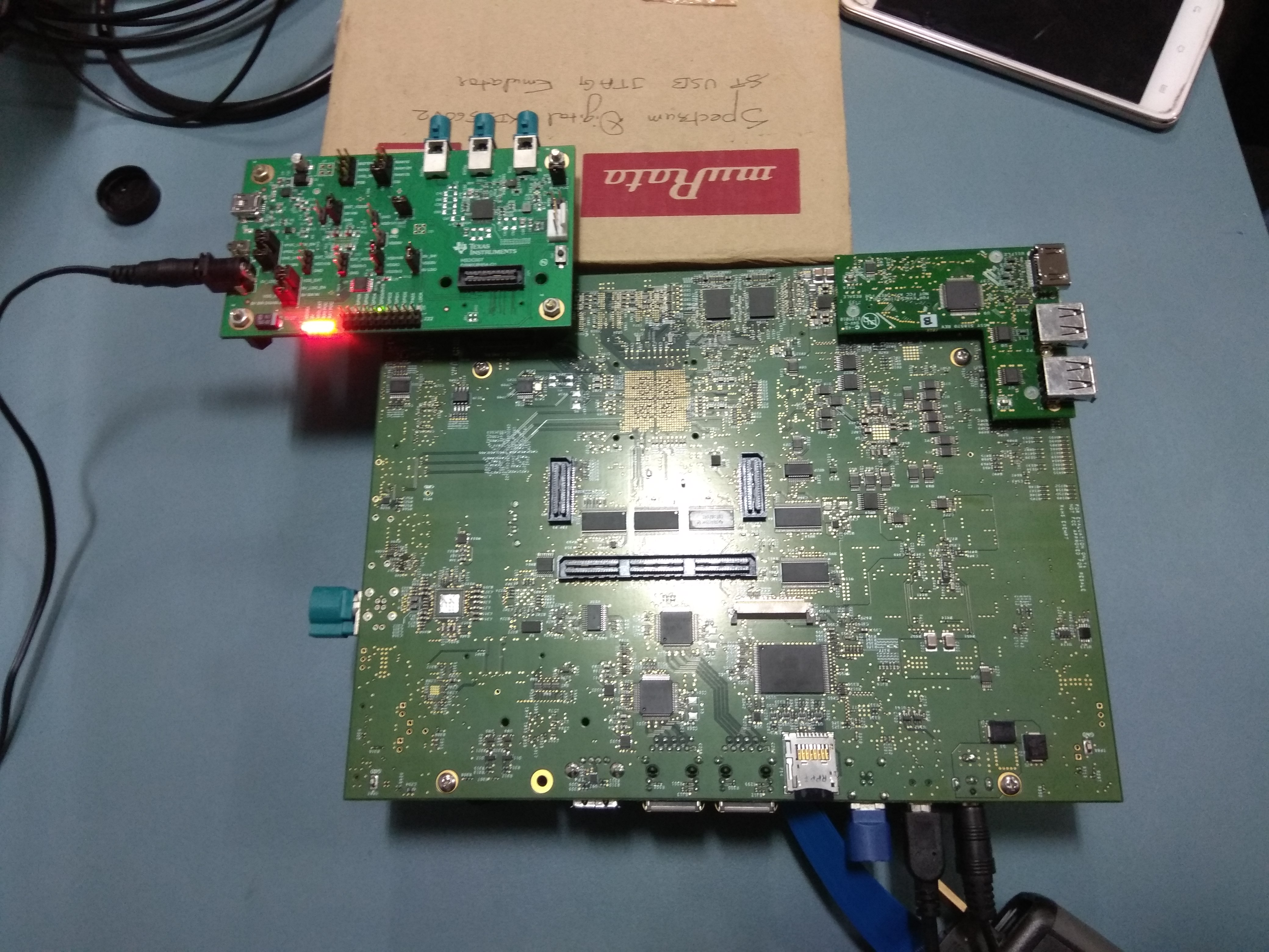

  • Hi Sujith,
    I tried using gUb954Cfg  values present in bsputils_ub95x.c  in deser.c. Still I am not getting any pattern(0x489B0304  - 0x4A054321, 0x489B0350 - 0).
    we tried Bsp_deviceI2cProbeDevice for deserializer, which was successful. Even we are able to read the data what we are writing.
    We have done setup like below. We are using tda2px EVm and UB954 EVM. We have removed sensor fusion board.
    Swati
  • Hi Abhay,
    This version of the UB954x is not yet supported. You will have to bringup this board.
    It's good that I2C connection is verified. Please get the schematics and check for lanes connections compatibility with TDA2Px.
    Sujith
  • Hi Sujith,
    We have confirmed the lane connection compatibility of UB954-EVM with TDA2Px-EVM wih out hardware team.
    You mentioned that the UB954x is not yet supported, so does that mean the example "\ti_components\drivers\pdk\packages\ti\drv\vps\examples\iss\captureIss\" will not work with UB954 EVM ?
    Abhay

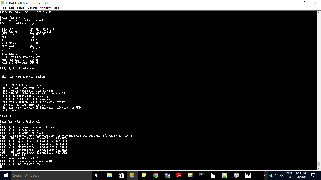

  • Hi Sujith,
    We are running "captureIss" example. But it is going in infinite while loop CaptureIss_main.c[line 450]
    while (appObj->rcvedFramesCount <
              (appObj->numFramesToCapture * pCfg->numStreams))
    Swati
  • Hi Abhay,
    There seems to 2 versions of UB954x board and the board that you are using is not tested by VisionSDK/PDK.
    Hi Swati,
    What is the I2C address of UB954x is it 0x3D or 0x30? From the log that you have attached. It seems like there is device at 0x30.
    Sujith

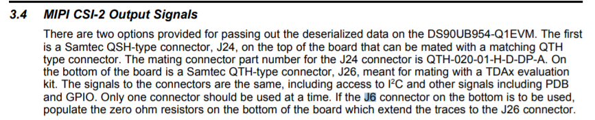

  • Also, you should have an EVM guide. Can you share that please?
    Sujith
  • Hi Sujith,
    Here’s the link for user guide

  • Hi Swati,
    Did you check on the following from UB95x user guide.
    Sujith
  • Hi Sujith,
    Thanks for reply. Do we need to mount 0 ohm resistors ( R60-R69, R71,R72 0Ω resistors) at the bottom of the board.
    Abhay
  • Hi Abhay,
    Can you request your h/w team to check out the userguide/schematics and make the necessary changes?
    Please note that are high frequency signals, exercise caution while making these changes.
    Sujith
  • Hi Sujith,
    For DS90UB954-EVM, currently we are not able to get 0 ohm resistors of 0201 SMD package. So will it work if we short the lines for R60-R69, R71 & R72 instead.
    Abhay
  • Hi Abhay,
    These lines carry high-speed signals (800 MHz), a lead short might have other side effects which could be difficult to debug.
    Also note that you will have to connect R71 to 0_0201_BOT_CLK0_P and so on.
    Sujith
  • Hi Sujith,
    We mounted 0 ohm resistors and we are able to test the pattern generation code with UB954-EVM.
    Thank you for your support.
    Abhay
  • Hi Abhay,
    Thanks for the confirmation, it would help other if you could list the changes that you had to do and mark the thread as answered.
    Sujith
  • Hi Sujith,
    As we were using the back side of the ds90ub954 evm..we had to mount the 0 ohm resisters on the CSI data lines.
