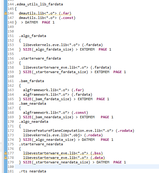

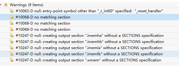

The EVE cmd file had some warning
1. How can I clean the no matching section warning?
Remove the lines corresponding each section form cmd file where the section is present in the final binary file.
This warning is not harmfull
