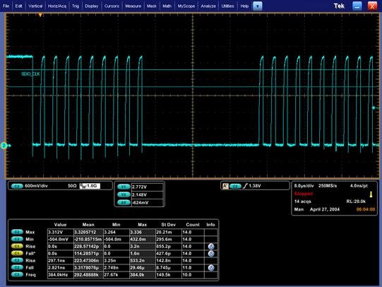

we have some questions about AM437x I2C timing.
In  the spec of am4379(Table 5-84), the minimum value of I2C  fall time should be 20+0.1Cb ns, but the test result is about 2.8ns
And
1. I2C is in fast mode
2. We  measured section is 10%~90% falling period
please advise
BR
Yimin

  • Yimin,
    What is your pullup strength on the I2C bus?
    Which specific processor balls are you using for this I2C?
    Can you specify the timing for both the case when AM437x is driving the I2C bus (e.g. while it outputs the slave address) as well as the timing observed when the slave device is controlling the data line (e.g. during master receive)?
    Are you seeing this timing on both the SCL and SDA lines?
    Brad
  • Hi SIr
    1.I2C Bus Pullup Resistor is 2.2k.
      The signal we tested is AM4376 I2C0 connected with PMIC. It is pulled up to VCC_3P3V ,which is provided by PMIC DCDC4.
    2.  The photo was captured when system power on then am4376 was communicating with PMIC. And  AM4376 is driving the I2C bus.
    3.  Yes, SCL and SDA falling time is almost same.

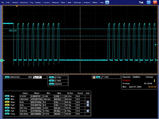

  • Hi Sir
    we refer to below document about I2C Bus Pullup Resistor Calculation
    It indicated that the pull up res impact on the rising time. But it seems unhelpful to the I2C falling time.
    Refer to below pic, the rising time pass, but the falling time is only about 2.8ns.Can you help to confirm how to adjust falling time of I2C?
    BR
    Yimin

  • Hi Yimin,
    The AM437x I2C min rise/fall timing for fast-mode does not match the I2C standard’s min rise/fall value of 20+0.1Cb ns. This is because the I2C was implemented using a standard LVCMOS I/O (rather than an open-drain I/O) on AM437x.
    We will address this in the next AM437x documentation release.
    Melissa

  • Hi Yimin,
    I apologize for the delay. Below is an update to your questions.
    1. The right value is that there is no min rise/fall time associated with the I2C fast-mode.
    2. Our current plan is to publish this as an advisory in the device silicon errata. The release date has not yet been set, but I should know more in the next ~2 weeks.

  • Hi Yimin,
    We've decided to address this in the datasheet, rather than the errata.
    The next datasheet release is planned for mid-November and is scheduled to include this I2C update.
