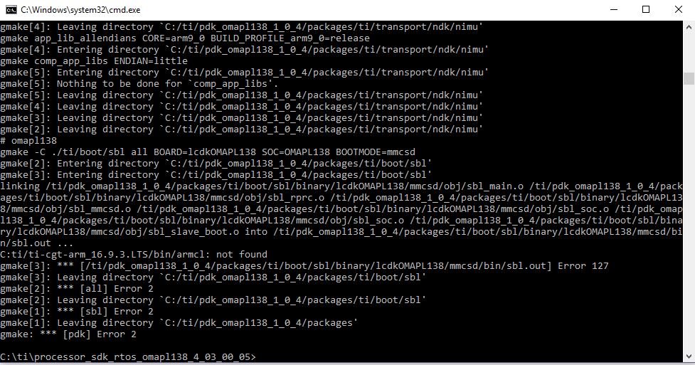

I Have installed the SDK examples in my code composer workspace and I am trying to create a new project and run that example code in my new CCS Project.
I have correctly added the paths and include options, but still, after resolving tons of error I am stuck on this one.
Please have a look and try to help me with this.
